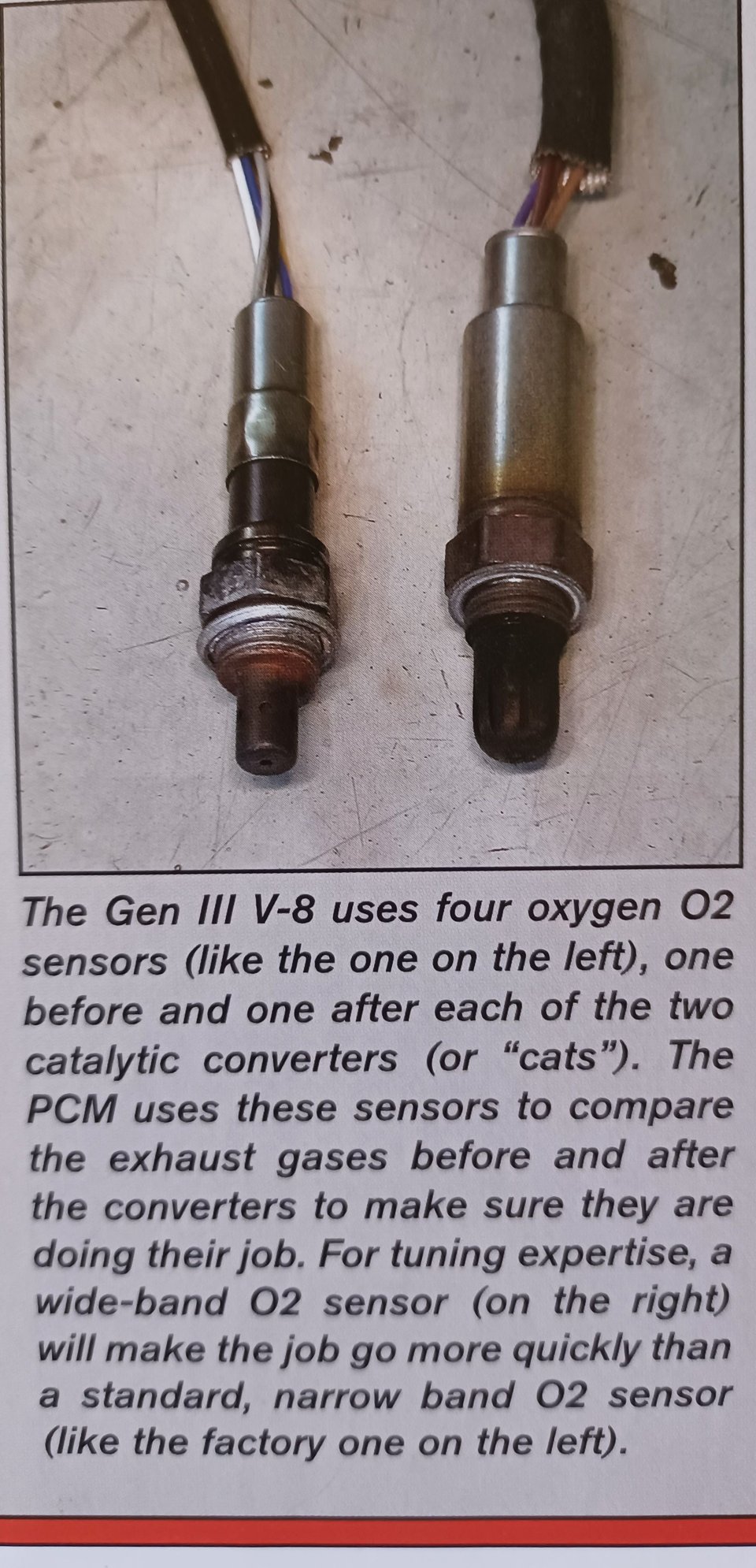

My 01 Ws6 has a V9G vortech supercharger and had or maybe still have codes p0171 & p0174. Well I found a major vacuum leak and a bolt missing from my passenger side catalytic converter which I have repaired and replaced. I decided to replace the o2 sensors with stock Ac Delcos and after doing so I seen this image in one of my Ls1 books saying the o2 sensor on the right is a wideband o2. I replaced all 4 sensors but the ones I pulled all look like the image on the right, can anyone tell me if these are just old stock o2's or are they really wideband o2 sensors?

They aren't wideband sensors, just aftermarket.
A lot of bosch 02 sensors look different.
