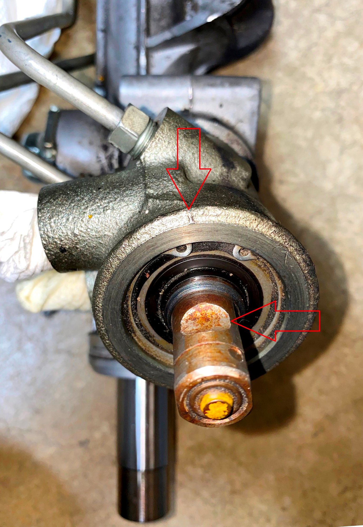

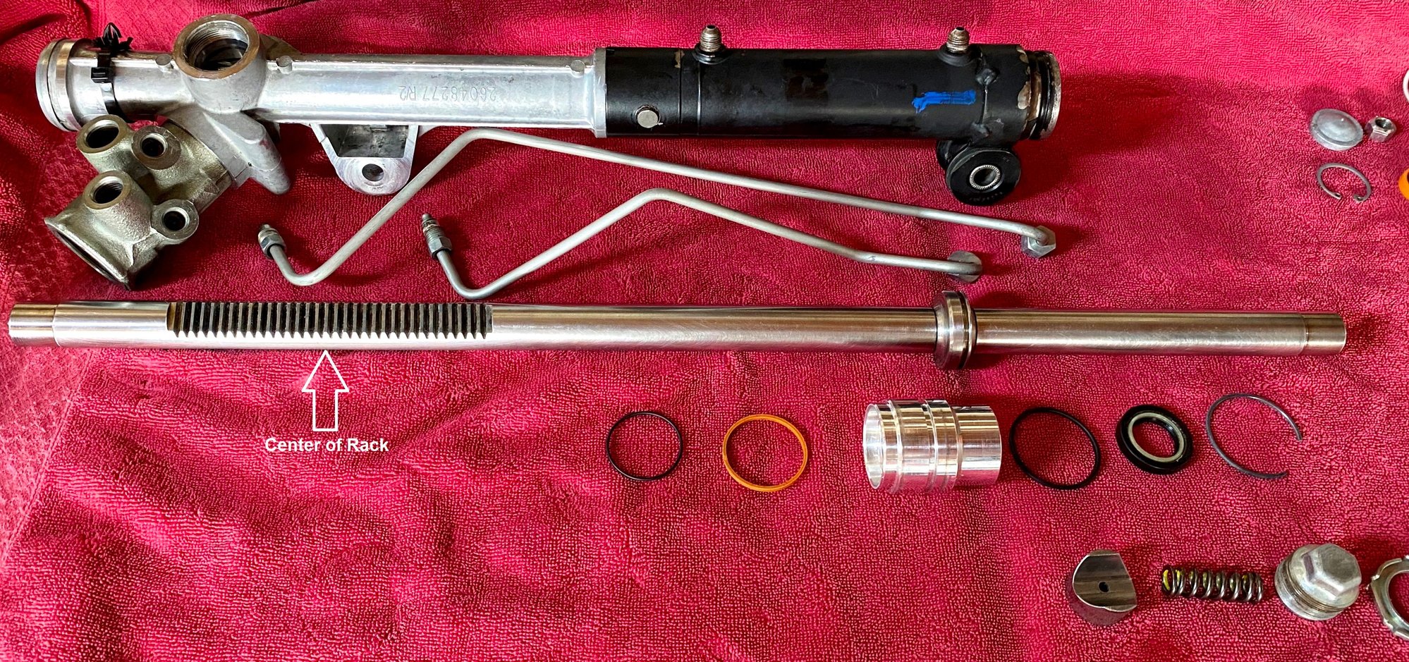

When I rebuilt my rack and pinion I turned the input shaft all the way from the right to the left and counted the turns (2-1/4 turns lock to lock) so half of that would center the rack (1-1/8 from left or right to center). The trick is getting the input shaft in the correct position and checking it as it tends to rotate a bit when reinstalling. If its not centered you will end up with more or less turns when turning right or left.
