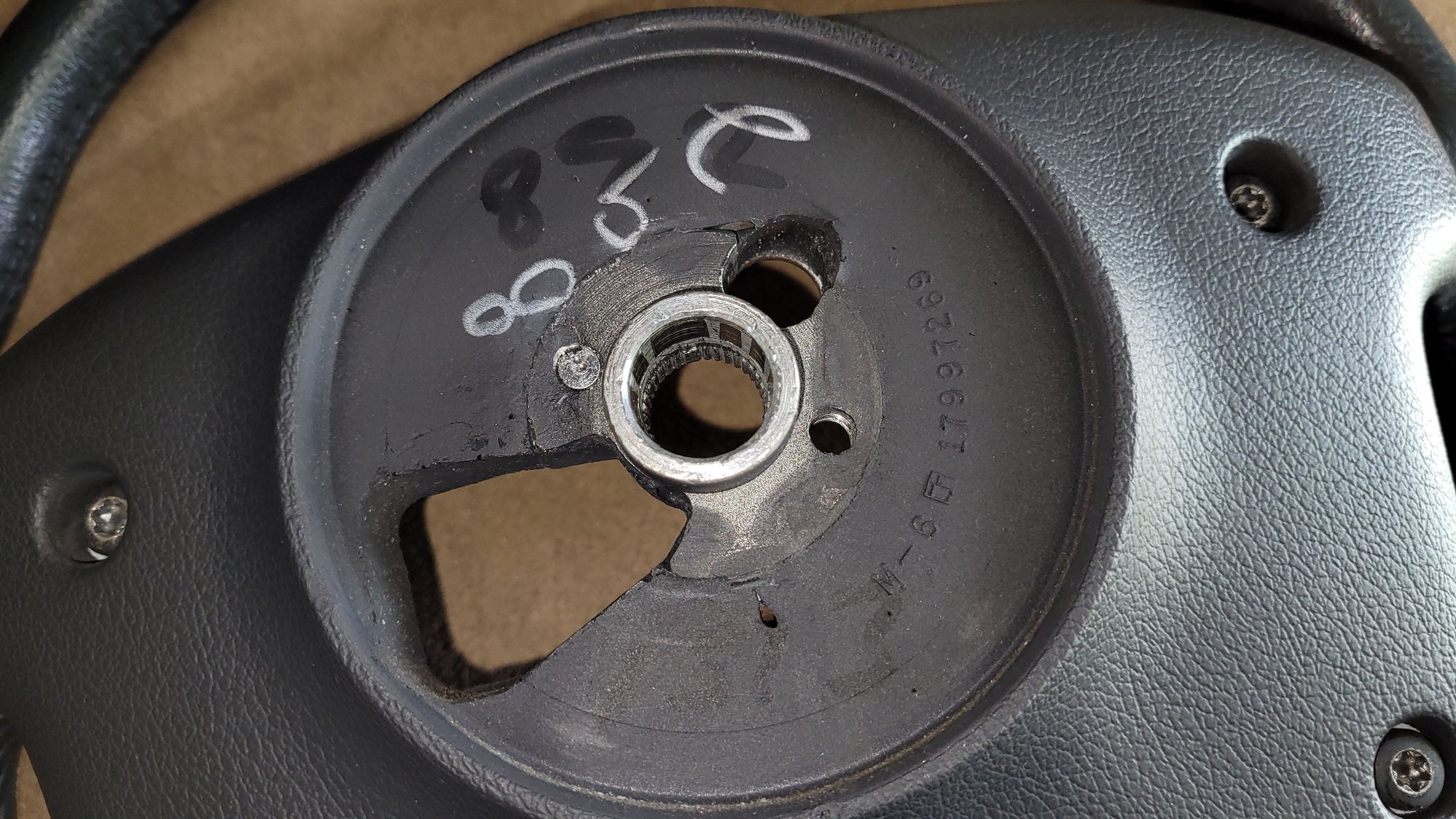

Looking for advice on how to get this sucker out. My handheld corded drill didn't even put a mark in it. Went to a local machine shop and they said they couldn't help. There's got to be some tool or machine out there that can drill this out.

possible to have another bolt tack welded on to that and back it out? or use a diamond tip drill bit and use an EZ out

Went to a handful of places around where I live, no one was able or willing to help. The place that gave it a shot said they used a $600 drill bit but even that barely put a mark on the broken bolt. I ended up ordering a re-leathered steering wheel from Hawks Motorsports.

I can't even count how many times this has happened to me. I got the bolt out every time.
I would try tapping a center punch in there lightly to free it up from any threads it might have deformed in the steering wheel. Usually when I take a drill bit to these, the whole bolt spins right out - before I can ever get a screw extractor in there.
You might also try a self-tapping screw. That should put more friction on it than a drill bit and might spin it out easier.

Good idea about the self tapper, I'll try that thanks.
