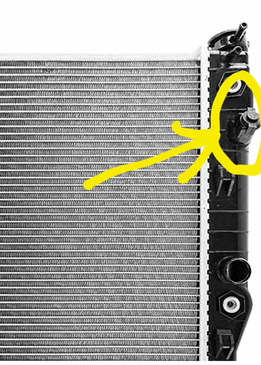

Had to order a new radiator for my car, a 2000 Trans Am.
Spectra Premium, which is what the car had, has 2 options. One with a (roughly 1") hose on lower driver side, and one without. Mine only has the 2 radiator hoses, and the nipple for the steam port/vent.
The one I ordered is wrong, as it has an extra unknown "port", on passenger side (see pic). No idea if I can simply block that port off?
Regardless, it was wrong due to not having the steam port nipple. Picture didn't show this other unknown port, and I am wondering what it even is, as my car has never used this, since I have owned it.
Also, open for any suggestions, for a nice radiator for a 800-900ish hp turbo car, that installs like stock one. ie; I dont want to cut the core support. Stock radiator has about 3/4" clearance between it and turbo, FWIW.

That should be the location for the low coolant sensor.
