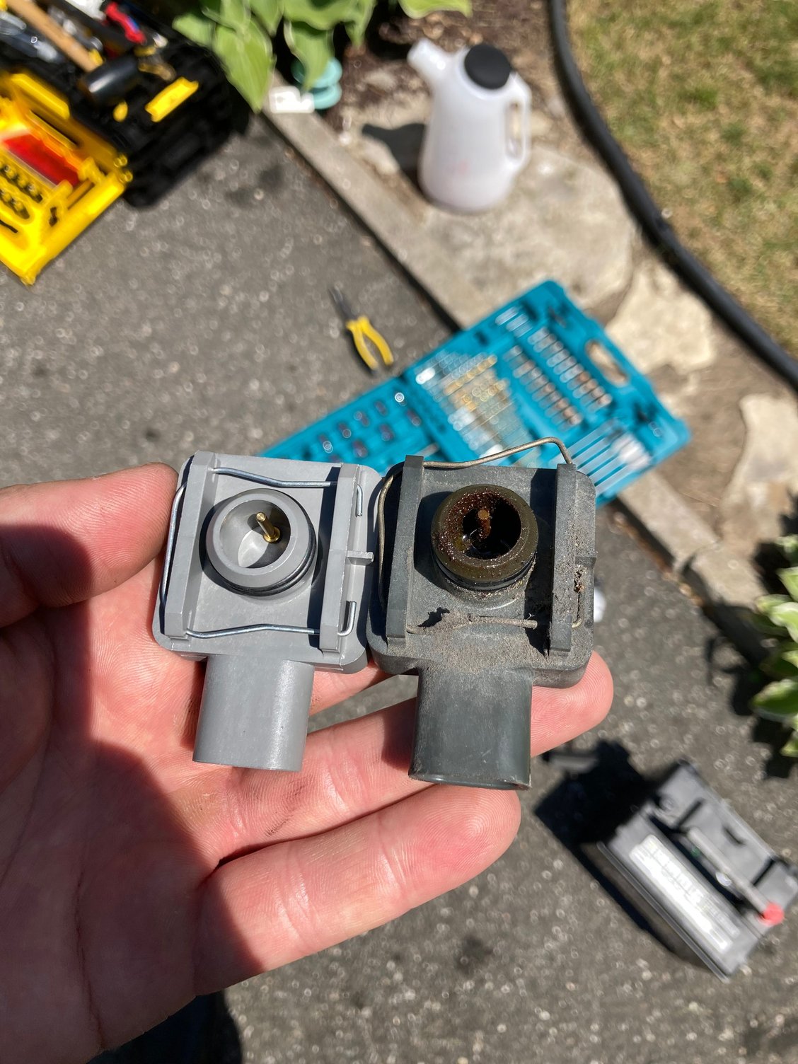

My low coolant light was on constantly after 5 mins of driving but coolant level was always full. This is what the sensor looked like. I believe this is due to dexcool. I am currently doing a drain+refill with universal prestone every week until all orange is removed.

Replacement part used is NGK #EE0017, so far working well after 4 hours of driving the low coolant light didn't turned on

These sensors do fail, often gummed up with old coolant. Dexcool itself is not the problem, it's only an issue if the system is not properly maintained.

...and if you simply unplug it, no light... They got rid of it anyway after '98 or '99 I believe...
