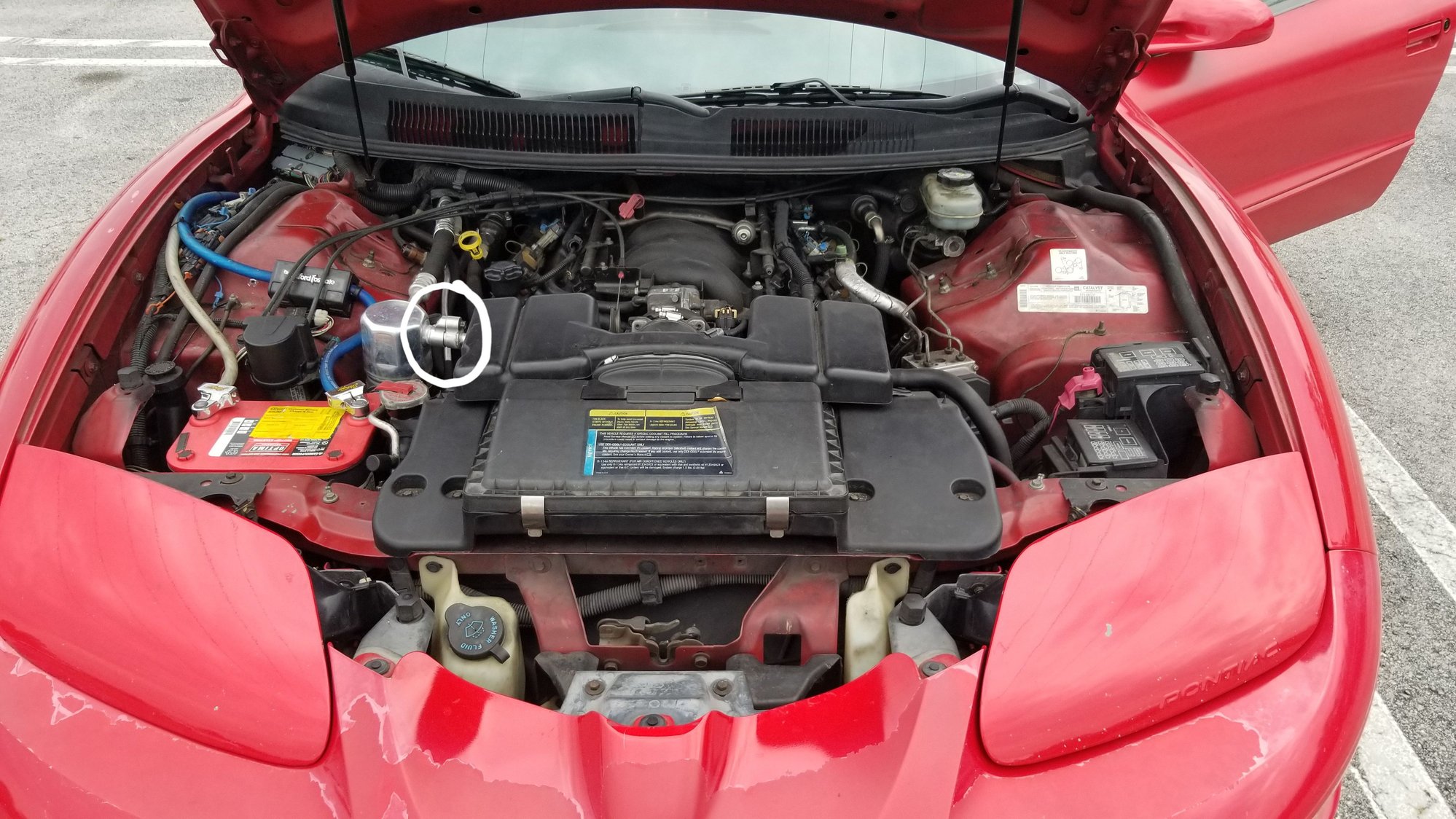

I have an ac leak at this location the system was brand new 2 years ago i had to do some work and had to disconnect this connection in the picture i have replaced the seal multiple tines....tried stop leak...i still keep hearing it leak. Is their a 2 bolt mod bracket for this or something?

Are you replacing the seal with ACDelco 15-2722 ?
I didn't have issues when I put my A/C back together \ no leaks using all AC Delco gaskets, I don't know about a 2 bolt mod/bracket either (I did have my doubts how well it would seal when putting it all together).
Here's the list I made from someone's reply / new replacement part numbers, not 100% sure if everything is accurate as far as placement, but the part #s are all correct/what was used. 👍

I just went to oreillys and get the ac gasket kit ...i didnt know their was specific ac delco gaskets for it. Ill try and see if i can find them.

Yep that work defintely were a different size.
