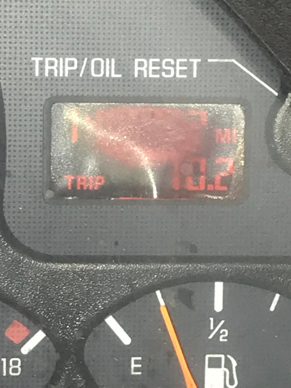

So the odometer screen is looking pretty bad. Any way to repair this? 01 trans am

This thread shows some of the ODO module: https://ls1tech.com/forums/appearanc...ed-screen.html
If you take the cluster out and remove the ODO module, you should be able to see what is going on. It looks to me like the smudge is on the overlay covering the ODO module. If you take the module out, you should be able to get to the smudge.

to me it looks like a layer of film is separating.

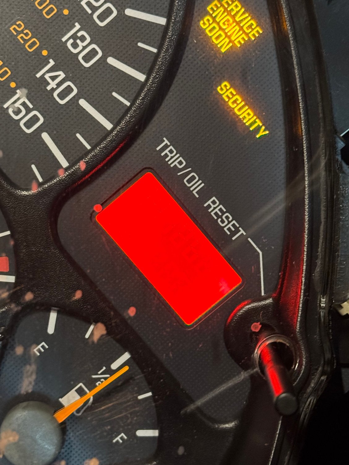

I replaced the film. Pic doesn’t do it justice after I uploaded it which is weird. Looks fine on my phone. But it looks way better and I can read it.
