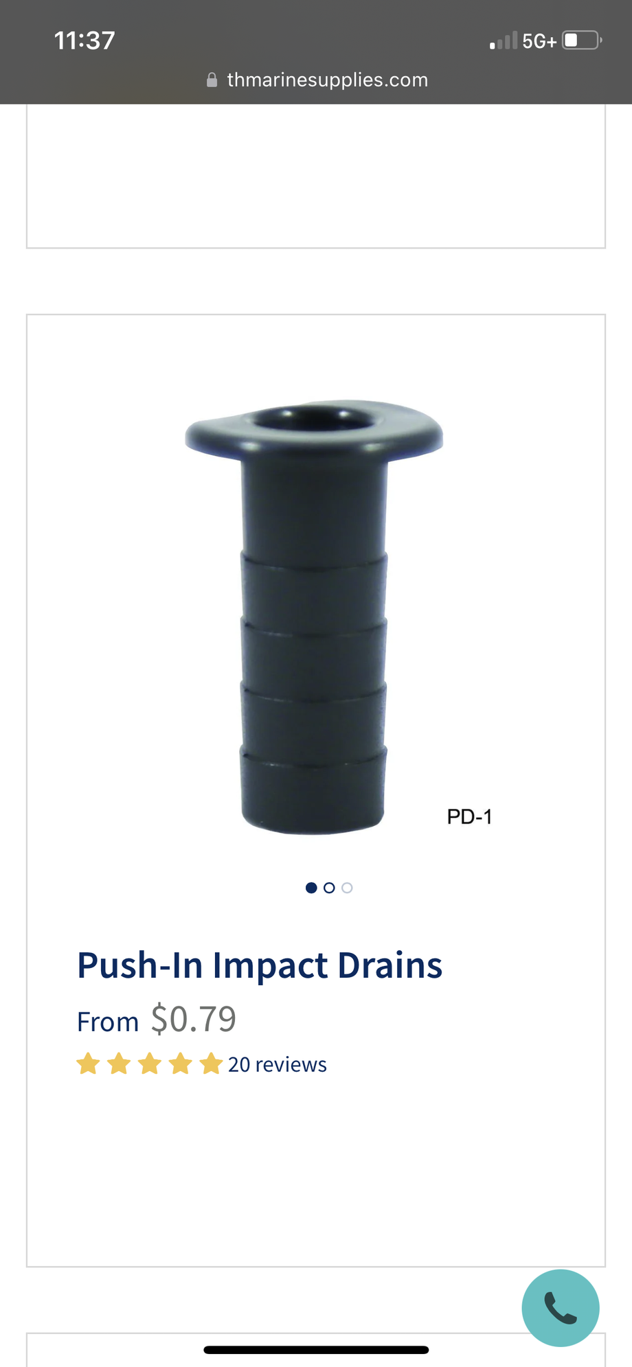

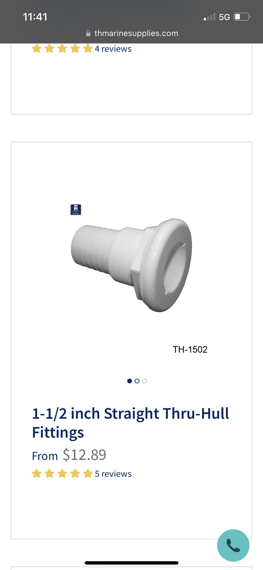

I recently purchased my second F body, ironically enough it is the exact same color Z28 as my first. However after getting this one home, I quickly realized there was water everywhere. I tore the interior out and did some research much of which was here. (My first one was in pieces most of my ownership in a garage, so it never saw much rain.)
I’m sure I missed a lot of posts on this topic, but I haven’t seen anyone mention putting a drain plug into the trough/gutter where the water likes to collect? I was debating drilling my own hole there, sealing it with some 3M, and running an exit tube down to the already existing drain plug at each corner of the trunk.
I was thinking of something like this

Any off chance you’ve seen anyone attempt a drain there?

You don't want a drain. The minute you put one in, the metal will start to rust around the hole.
The problem is water coming in, not draining it out. There were TSB-s for harch drains and lots of other things to check
