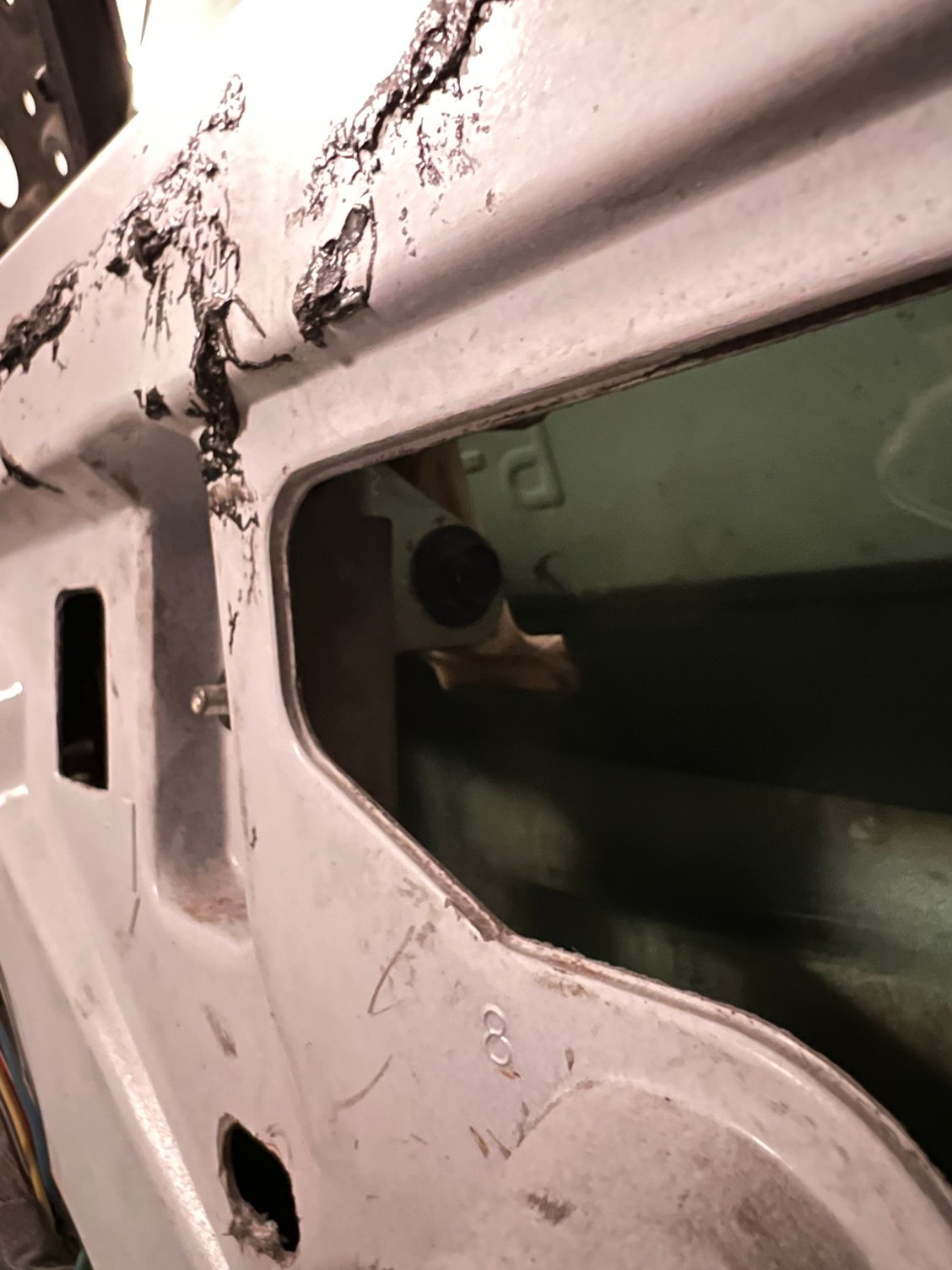

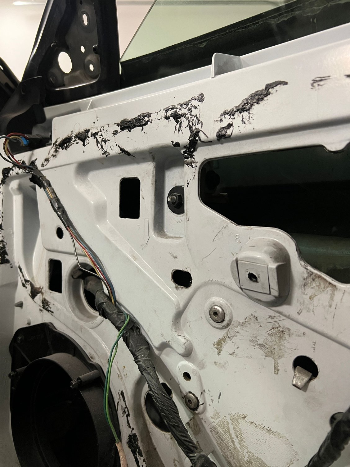

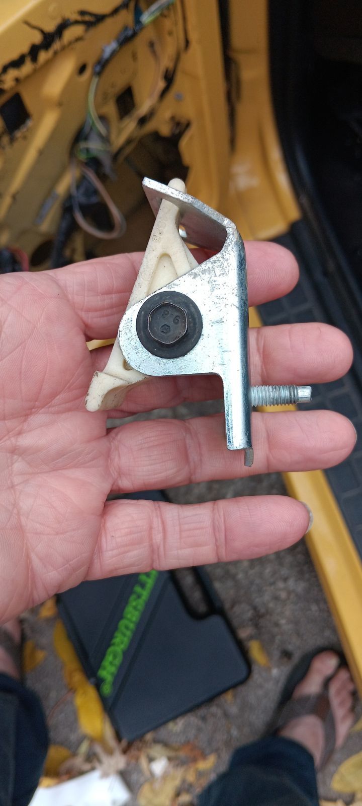

Had some1 was to put a new window reg in drivers door, and they left and never came back. He had disassembled the door part way and left the parts on the drivers floor.
I have 1 part I cannot find on a schematic, and I have looked at a dozen. If any1 knows what this is and how it goes back in the door pls help.
Thanks

This is the RH side however if you mirror it the same spot is actually in your picture. Another thing to note: each adjustment point is numbered with arrows denoting which way to push as you go. This is position number 7 of the sequence.

I don't remember seeing that part when I had mine apart.

This controls the tilt of the forward part of the glass.
As you put everything back together, you'll want to be sure to follow the shbox sequence exactly for adjustment. The process and adjustments are non-intuitive and this guide will help avoid any complications: http://shbox.com/1/adj_window.html
