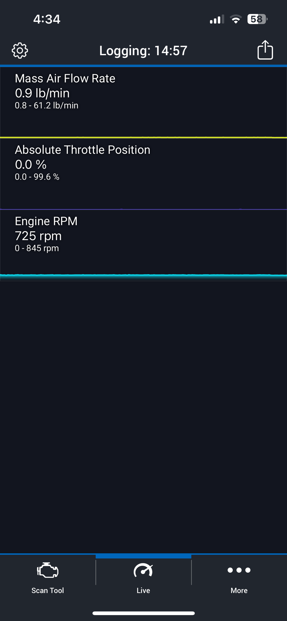

I’ve had the car since August of 2018, rebuilt the motor and other things (it was hurt when I bought it) and it was always close to where it should have been. This is a new thing where it’s just way off.
I went out and started it when I got home
from work today and hooked up the scan tool. When started it read close to 4K rpm and settled down to about 3k after a few minutes. Computer is showing 730ish at idle. Definitely looks like a cluster issue….I think.

So, I bought a used cluster from a local guy. Came out of a 98 trans am. Everything works great again! Figured I’d post my fix if anyone else comes across this post in the future. Thanks for the input all!
