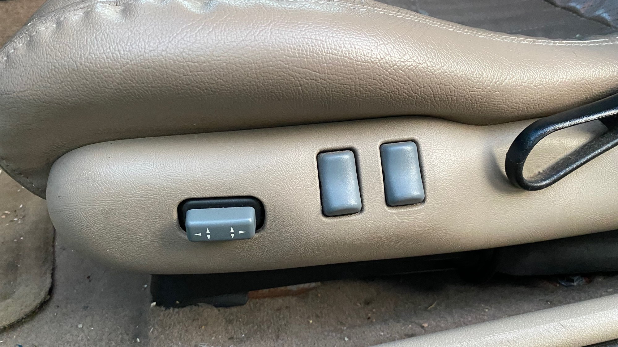

What options are there to replace the switch to move the drivers seat?
The forward backward seat control has stopped working. I know it is the switch, as I've swapped the plugs around with the up/down back of the seat base and it now goes forwards/backwards with that button instead. I can't seem to find a replacement, it says discontinued. Are there any solutions please?

Might be able to find one at Hawks or Ebay. Have you tried cleaning the switch with CRC electronic spray?

That's a rare part. I believe it was a part of the lumbar support option.
This thread has links to detailed procedures on opening the switch and cleaning it: https://ls1tech.com/forums/pontiac-f...at-switch.html
You should be able to remove the dirt and/or corrosion on the switch contacts and be back in business. Being so low and under the seat, these things collect fuzz like a belly button.
