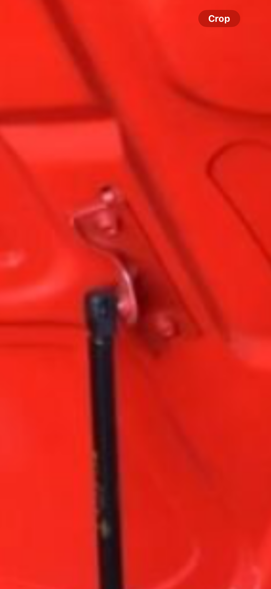

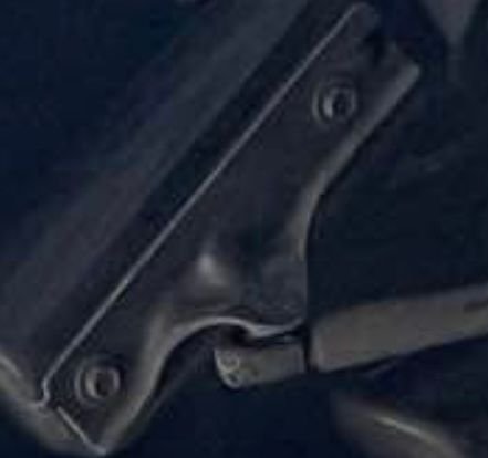

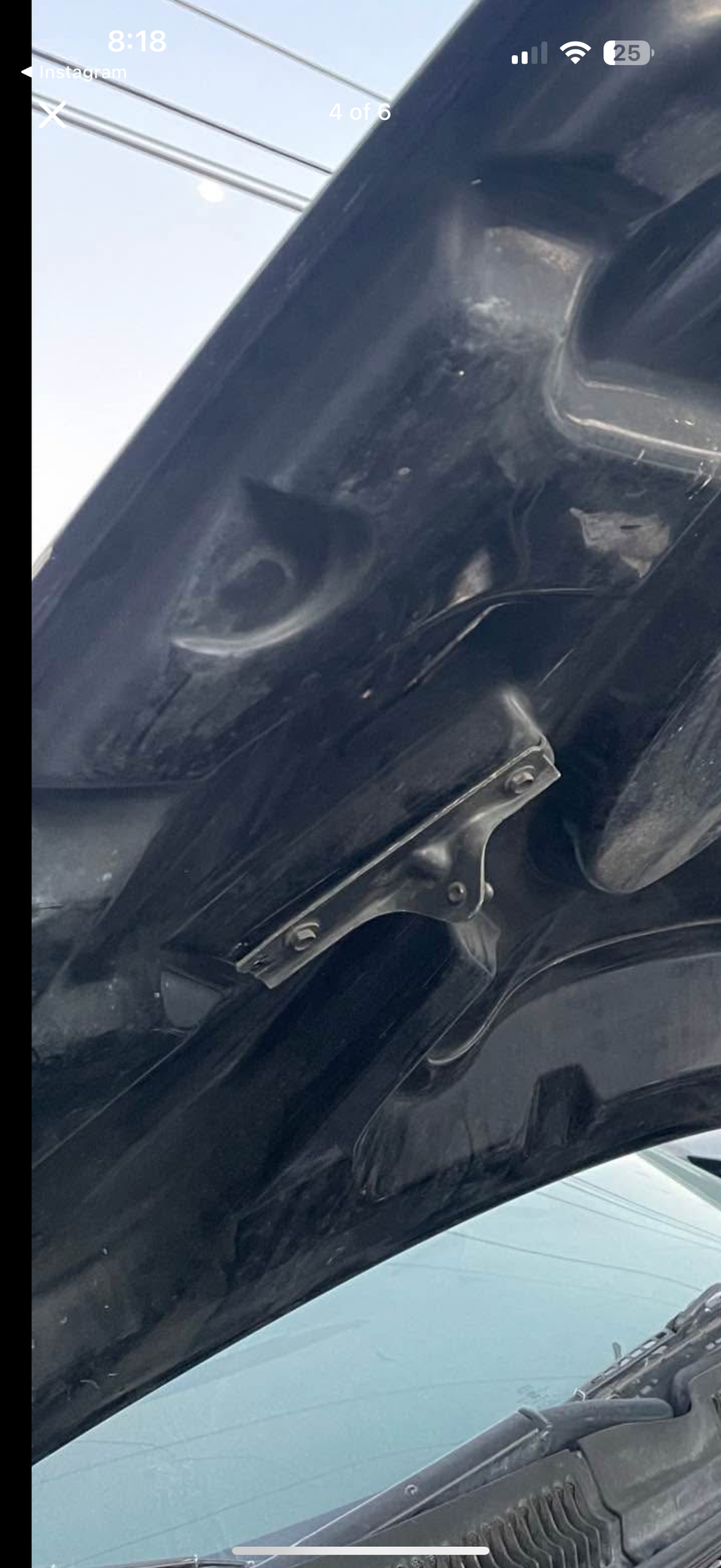

Hello everyone hope you guys are doing well I been looking for this bracket for the hood that helps hold it up I’m having no luck finding it would anyone know what’s it call and where I could find them if possible
This bracket name
This bracket name

Sorry about that it’s a 2000 Camaro z28 with a ss hood style

For the factory hood, LH 10182025 RH 10417379. Being that the SS hood is supplied by SLP in the SLP factory, the factory brackets might not apply if SLP had to use different brackets to accomodate the SS hood design.
