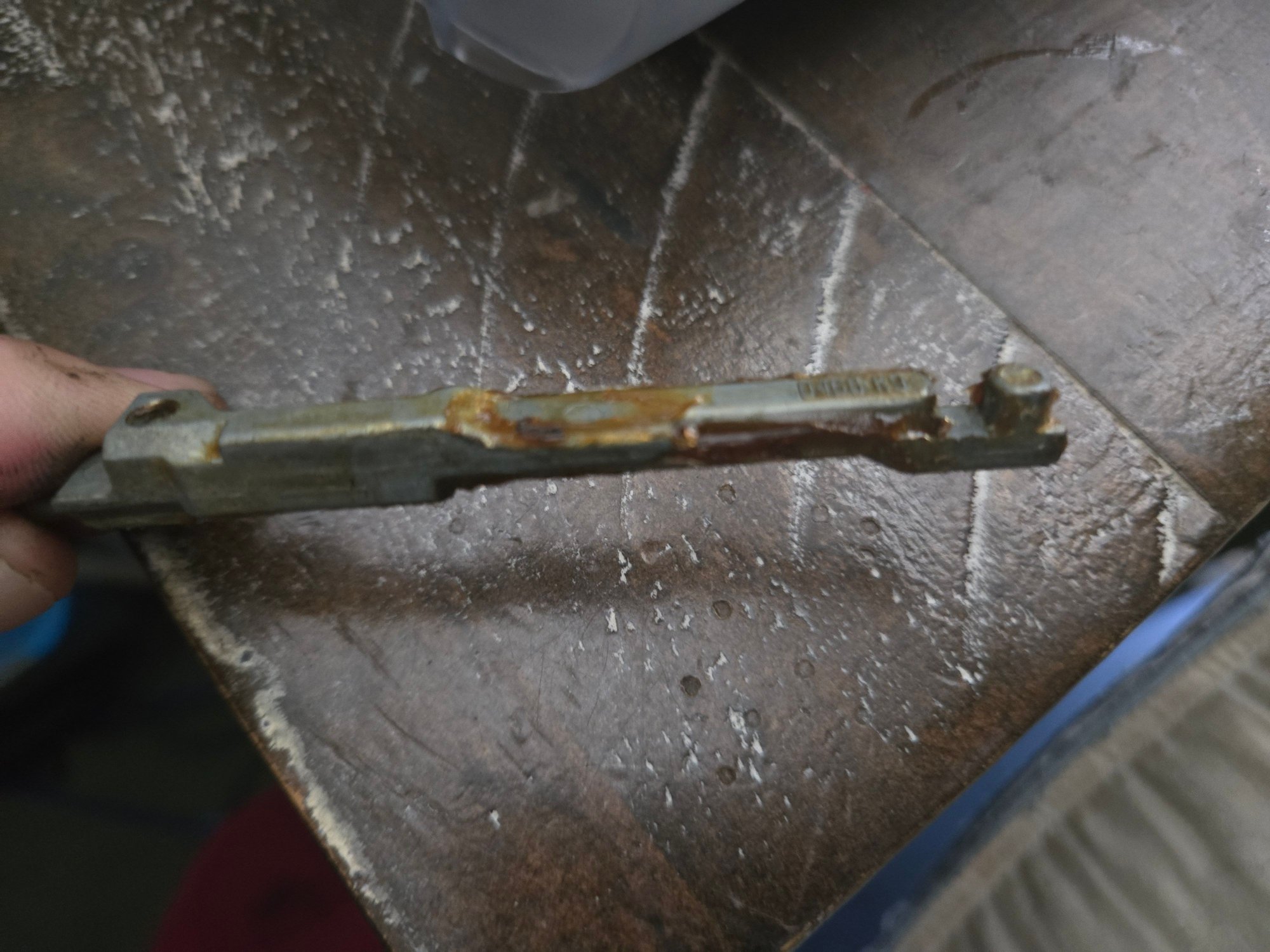

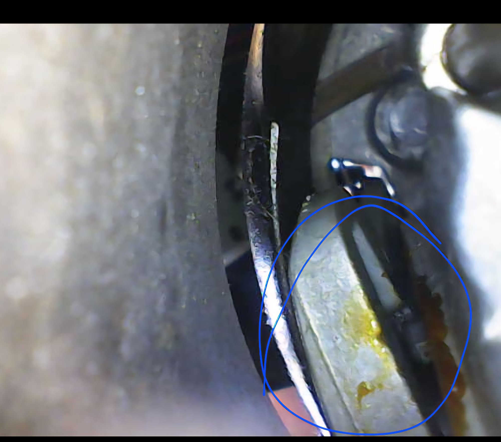

Narrowed it down to the ign sw rod. Looks like it came loose or broke from the linkage. I used a cam to look up into the column. Do i have to remove the tilt pins and remove the head to access this part?
Old Sep 14, 2025 | 11:45 AM
Daveone23's Avatar
Joined: Aug 2025
Posts: 28
How do you get the rod back on and why did it come off?
