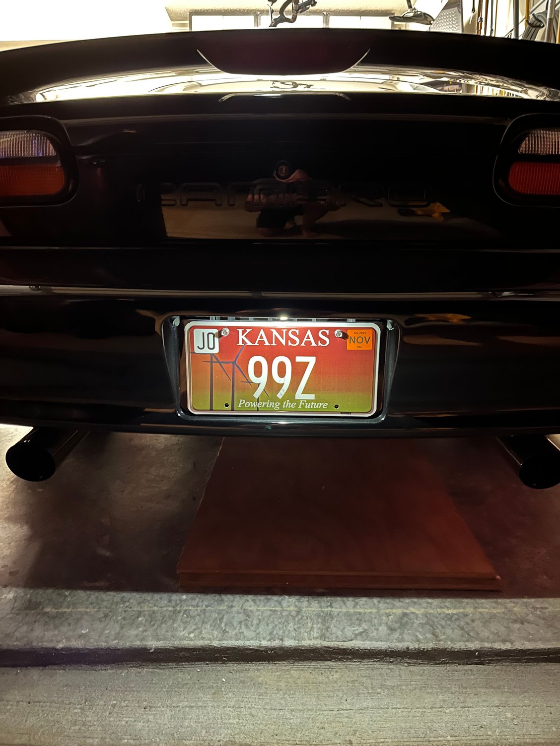

The plate lamp assembly is held in with 2 little screws. Its easy to get off. I replaced mine with a Sylvania ZEVO 194 LED. I tried a few other LED's but the tip of the bulb wouldn't allow them to fit. The ZEVO was the only one I could get to go in properly without modification.

Thank you for the reply, I see the 2 screws on the outside above the license plate
