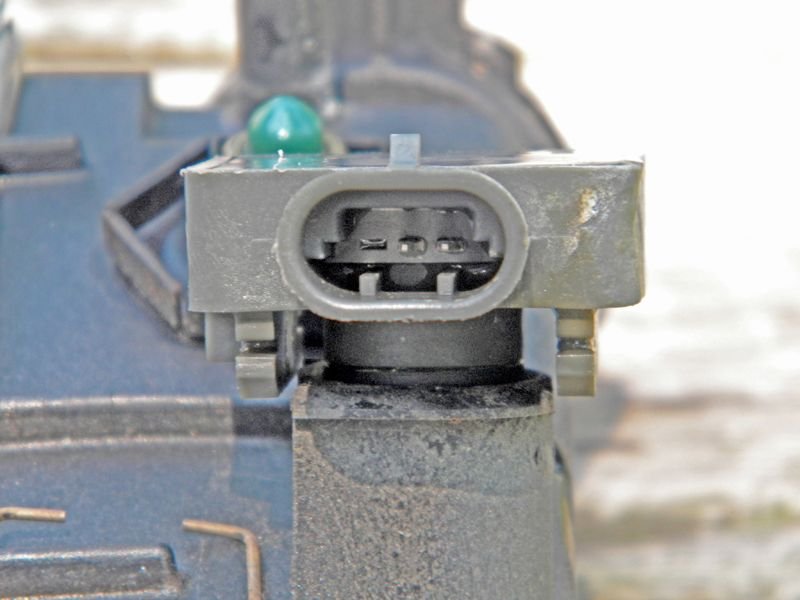

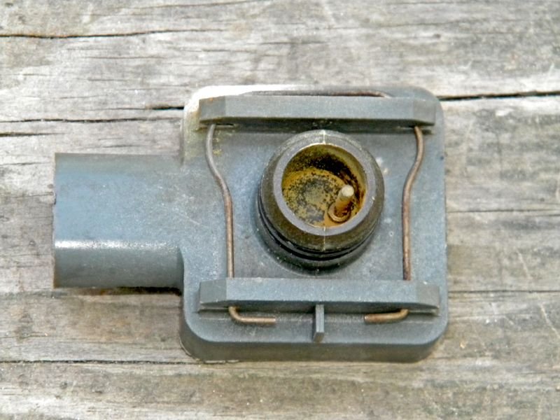

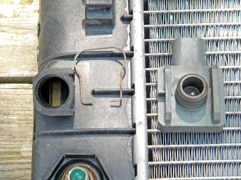

A screwdriver will get those ends to move and pop off, but watch out - the spring will go flying.
To get the sensor back on, I recall setting the thing like a mouse trap, with the ends of the spring resting on the plastic lip so I could twist the sensor on the bung and then press the closed end of the spring so it moves forward and snaps in place.
While you are at this, I would replace that sensor. (It is the coolant level sensor.) They don't last forever and (as you can see) are a little PITA to replace. Over time, they will corrode a bit and won't read coolant over the sensor.

Since you're replacing the radiator that it's in, just disconnect the electrical plug of it and leave the sensor in the radiator. once the radiator is out, you'll have better access to the spring clip.
I watched a few ytubers apparently they pry up on top clip an pry down on the bottom clip.then pull whole clip out side ways. I'll attach my magnet to the dam clip before fully removing. this sensor is orginal but goe's out intermitantly.
like I'll see the red arrow pointing downward then it goe's away. if it looks corroded I'll replace.

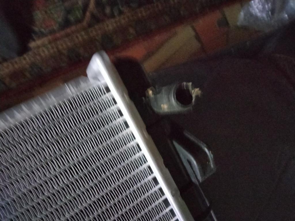

this rad. has an extra drain port
I believe it's for LT1 cars .whats an easy way to block this extra drain. I've read some sales reviews on these rads. an some mentioned there was a cap included mine didn't come w/ a block off an there are no threads inside where I can screw in another drain plug.

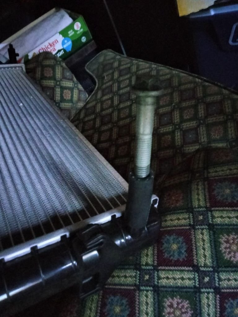

Update: I’ve come up w/ this hose an bolt to block off the extra dam hole.will cut the bolt shorter.
Since the supplied drain is cheesie cheap plastic this bolt blockoff mite be a more durable drain.

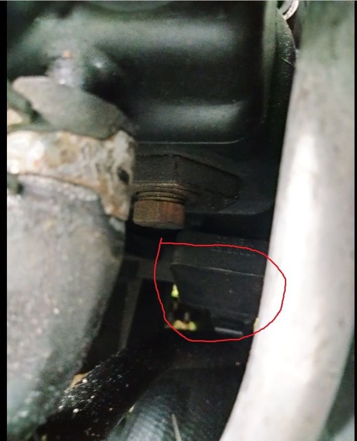

The other day when engine was cold I twisted off the orginal plastic drain w/ my hand it was tight but I was able to remove the dam thing. Different story today I couldn’t budge that dam drain plug w/ my hand an engine was a little warm maybe that plastic expanded?
I used pliers an ended up ripping the cheesie grab ears off the plug, ran the engine a bit to pump out whatever water was in the block to prevent block from cracking.
Next couple days will be in low 20*Far. Plan to swap new rad in mid week.

That's a LT1 Fbody Radiator. Same thing I put in my Monte SS. I put a rubber plug in the hole of that port, with a rubber cap over it. Been there for years with no issues.

You just have to cap the extra port. You can use a rubber piece of hose with a bolt (like the OP) or brass plug (or one with a built-in drain, if you can find the right size), or a rubber cap like Merv suggested. But if using the rubber cap, make sure it's a good one as some of the rubber coolant plugs on the market today are JUNK. The replacement water pump for my Olds 350 came with a rubber cap for the unused port on the pump (some Olds V8s connect the heater line to the radiator instead), and that cap failed after about 18 months. The rubber was only about half as thick as the better ones that Dorman used to sell over the counter.
