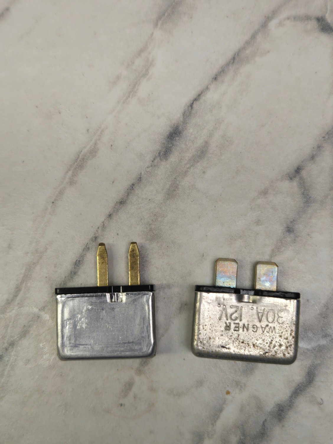

What is the pn for the 30a breaker. It has spades not pins

They are standard ATC / ATO circuit breakers available at any auto parts store or online.
ATC and ATO are different designations for what is essentially the same fuse. ATO (Auto Thermal Open) fuses are open at the bottom exposing the fuse element to the air for a little better cooling while ATC (Auto Thermal Closed) fuses are enclosed for corrosion protection, but they are the same size with the same spade terminals and are interchangeable for all interior automotive applications.
