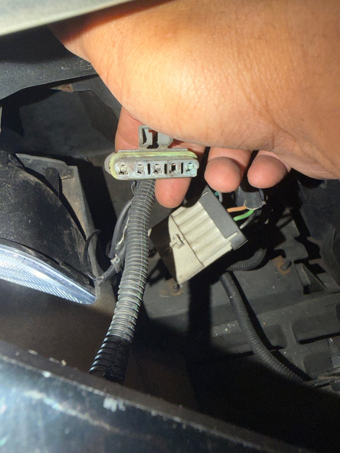

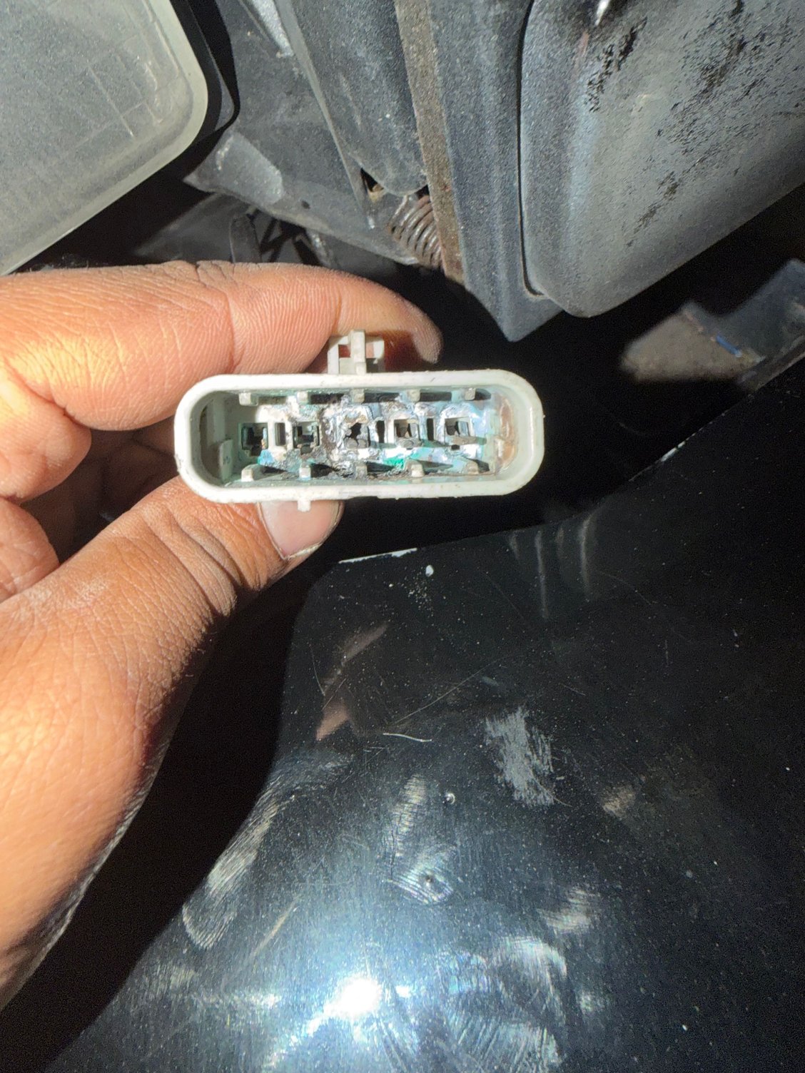

My 2001 firebird harness had some sort of corrosion and broke upon me replacing the motors how should I go about this I know the motor can be replaced but the pin on the body harness is f$&ked

I had corrosion on mine but not as bad as yours.....Delphi does make pins and the connectors....you would have to find the P/Ns to see if there are still available.....otherwise its junkyard time
I put dielectric grease on the gaskets now to keep out moisture

That is a common pin all over the car and for GM stuff. If you have the proper tools you can clip some connectors at the Junkyard, pop out the pins and splice them in on the car to replace them there. Then dielectric grease in the connector, that one seems to be getting a bunch of moisture for some reason.
