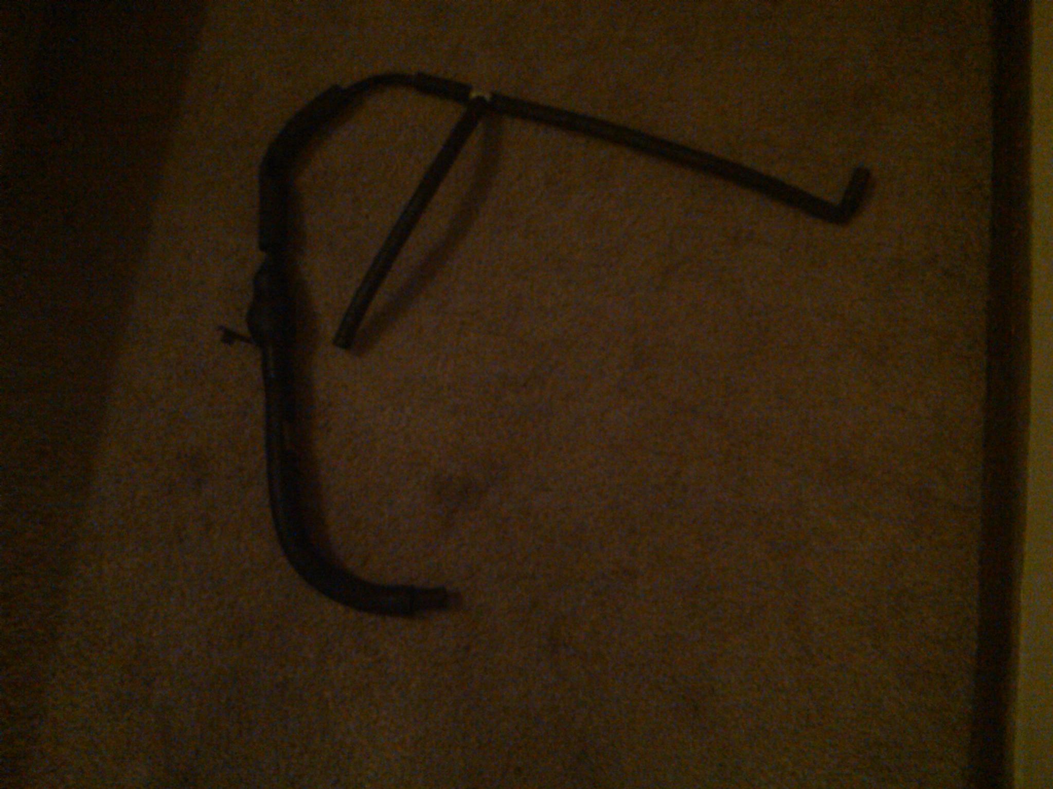

I think I broke the same Y your talking about.
You can buy whole new line with PCV, Y and lines from dealer for $180, or I just used original 1st piece coming off intake then bought 3/8ths fuel hose and a T fitting and then a 90 degree elbow so the line wouldnt kink on the driver side and just made my own.
Used less than 3 ft of line and 1 T and 1 90 degree. ~ $12

looks funny sitting off the car but fits perfect.
Not a bad idea, If all else fails I'll try this.
But idk where to get that clip.
Picture helps alot. Thank you.
