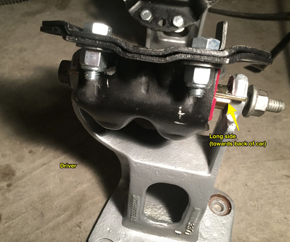

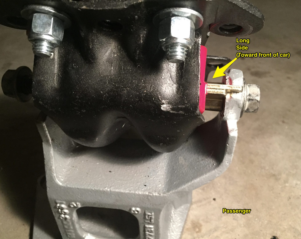

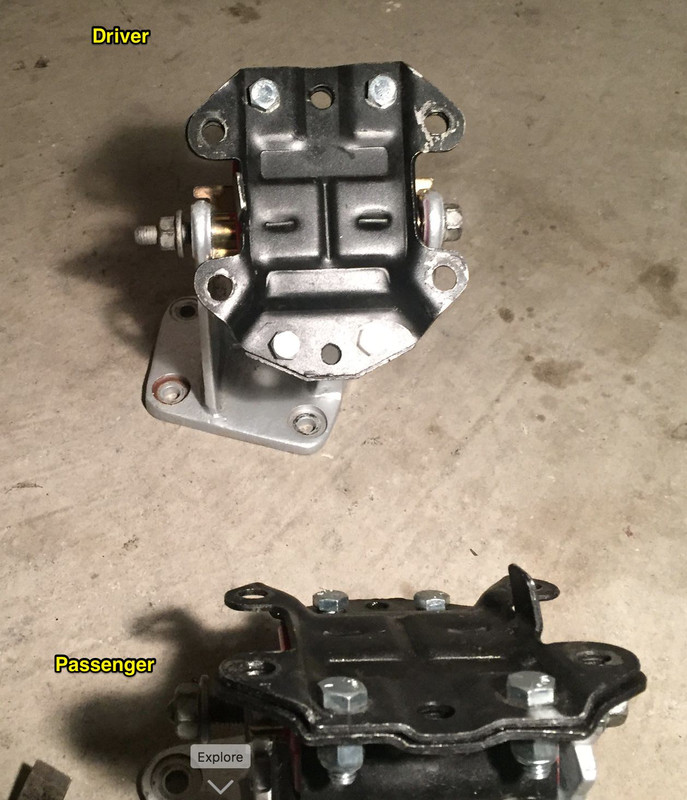

Double checking my motor mount alignment. The Prothane instructions say to have the tabs mounted upwards on both passenger and drivers side.
Driver's side has the long tab toward the back of the car, and the passenger side long tab is toward the front
