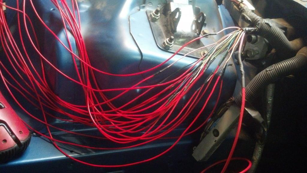

Like the title says I am trying to figure out what this guide module is on my car and if I can delete it. It mounts off the fuse box on the driver side and it would make running my intercooler piping a lot easier if I didnt have to leave it in there.

I believe that's the headlight control module for your popup headlights.

Correct. That is the headlight control module for trans ams

Yup, that's a Firebird headlight door module.
There's no reason you can't cut, splice and extend the wires and mount it somewhere else.
Just use more than one color of wire

Yeah I'm gonna cut the wires and put plugs on it and move it that way
