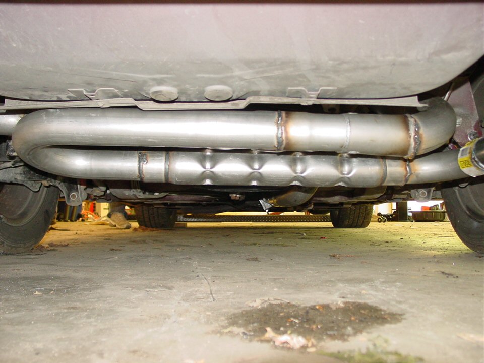

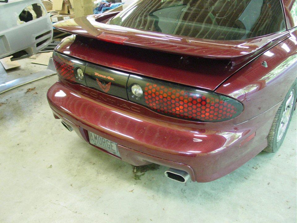

Spent Friday night and a little Saturday morning fabbing up my new Catback system. DynoMax I pipe, Flowmaster 2 1/2 to 3 inch collector, and some chambered mufflers. Stock exhaust tips, semi polished to be more of a silver color.
Pics:
Video (gf was revving it... will get a better video later)
http://amorget.pnw3.org/NewTA/exhaust.mpg
Edit: Oh, yeah, forgot to mention, the total cost of the system is about 230 dollars.
DynoMax I pipe and over axel: 90 bucks from Summit
Flowmaster collector: 40, or about that
Chambered Mufflers: 45 off E-bay, shipped
2 90s, one J bend: 36 for the 90s, 19 for the J
Misc pipe: 10 bucks
I also got 15 free from Summit, so that helped, too.

hats off to you man, looks like a great setup

Were did you buy the chambered exhuast? Nice set up look like a custom GMMG.
Old Jun 1, 2004 | 01:06 AM
Amorget's Avatar
Joined: Nov 2003
Posts: 828
E-bay, just look for a guy named exhaustdr2n7a That was just the mufflers, I did the rest of it.
Yeah, GMMG inspired it, but the 700 dollar price tag was a total turn off, especially for a car that I expect to remove from daily driver status in a couple months and won't see much road time for as long as I own it (forever).

I love those tips. Have any more pics of them? Would you consider fabbing up a set for me?
