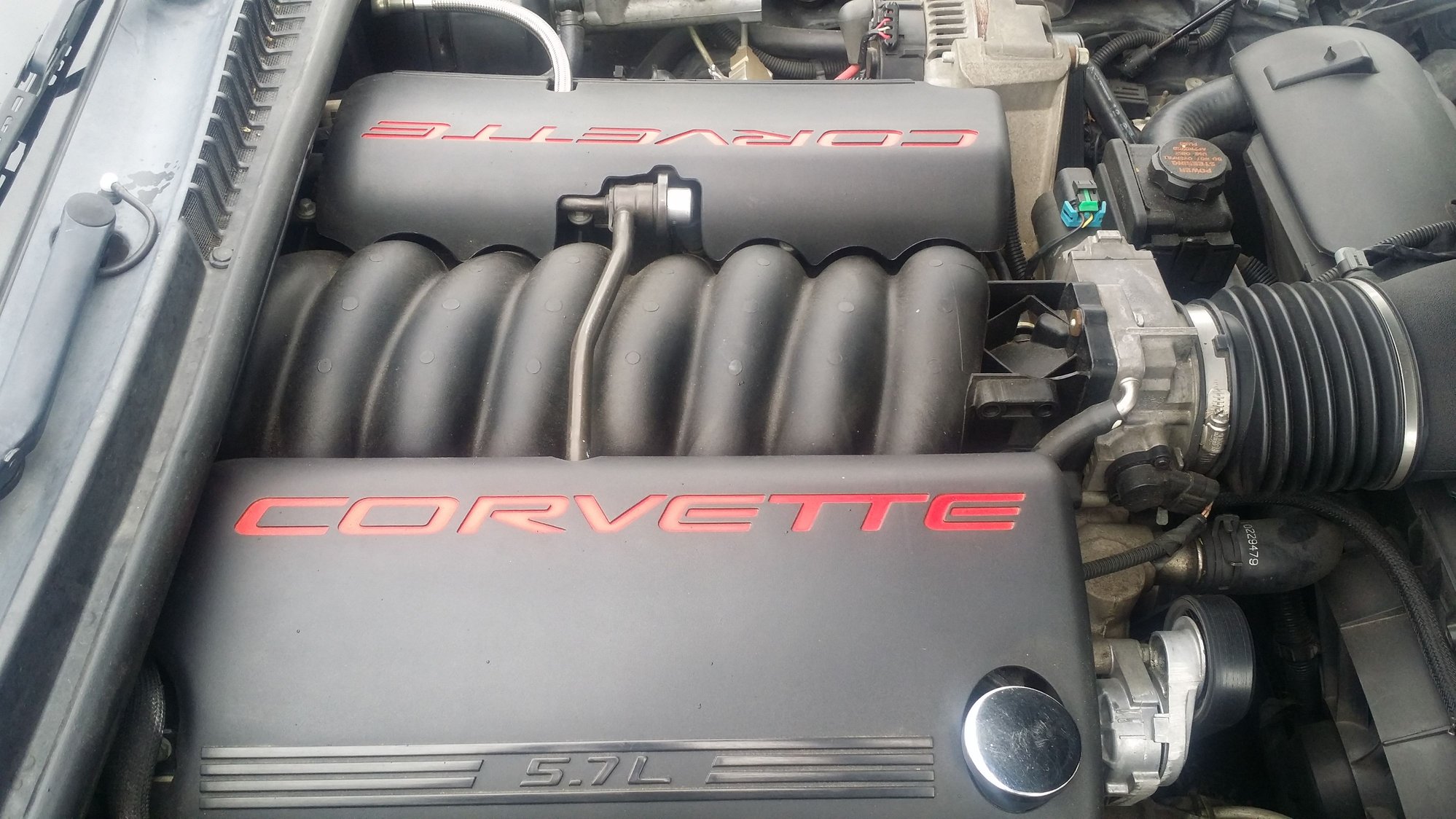

Which is this? It's a 2000 vette but I don't see the egr on it. Thanks!

Should be a casting number on it

Where is it located? I figured it could be checked from where the egr port usually is on top where that diamond shape is

The LS6 intake manifold was not available until 2001, so if that intake has never been changed on that 2000 vette it has a LS1 intake.

I have no way to to tell if it has been changed

Mine is on the drivers side. Pop the cover and shine a light and you'll see it. It's like a 7 or 8 digit number I think

The part # is on the big flat areas between 2nd and 3rd injector on the driver side of the intake manifold.

I'm pretty sure it's a ls1 guys, found out ls1 intakes never had egr on vettes. At least that's what I was told
that is true. you were toldcorrectly
