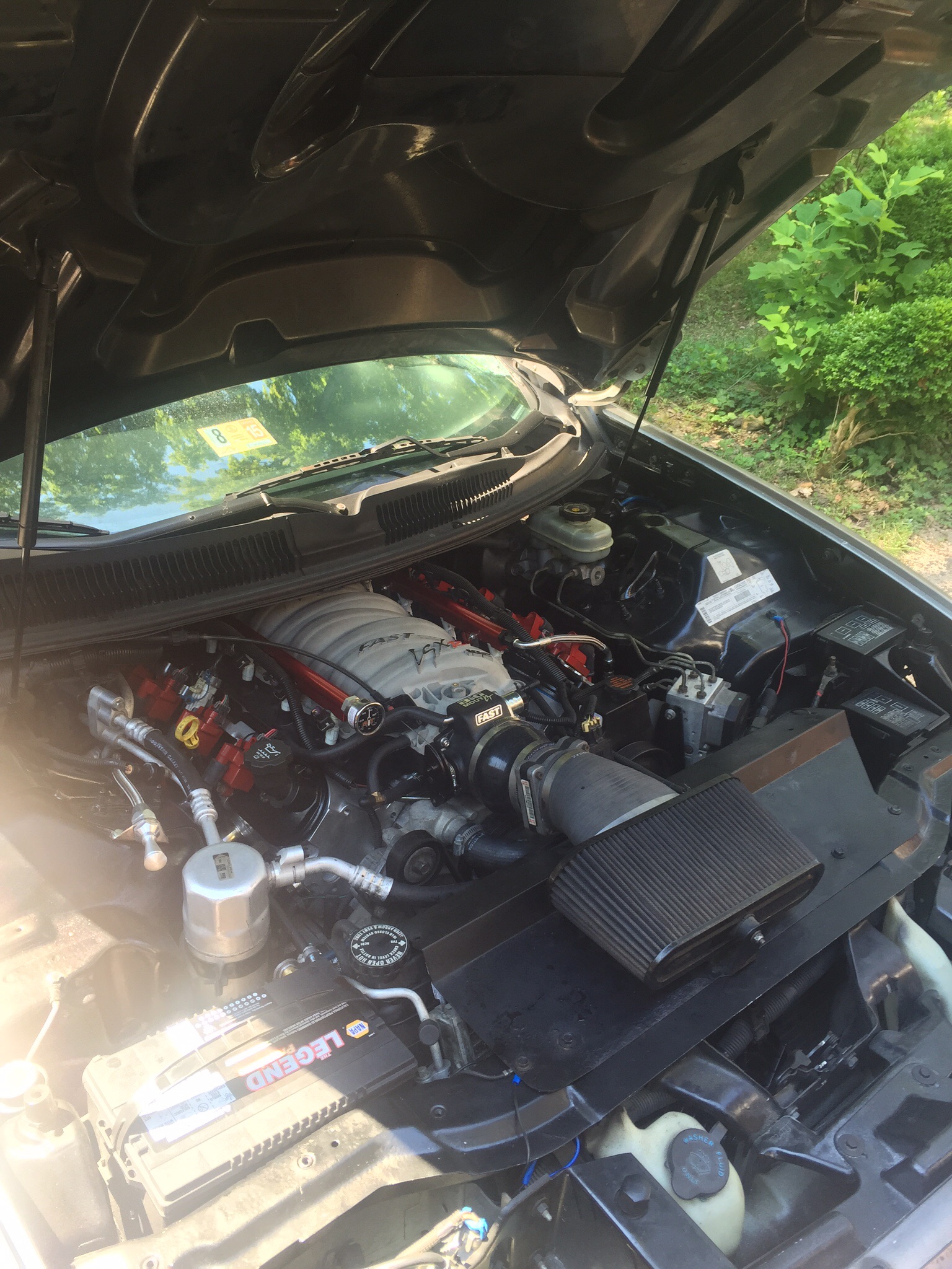

Tryin to get some insight on a problem I'm having. Any input is appreciated.. I did heads,cam, intake swap... Car has been dynotuned.. Runs and drives fine.. But on a cold start I have to give it gas to keep it running for about 2 minutes before it'll idle on its own.. Everything has been upgraded besides it having s stock bottom end and stock fuel pump. Fuel pressure reads jus above 60psi idling on its on..

You need to take it back to your tuner. It sounds like the RAF/base air flow needs to be tweaked.
