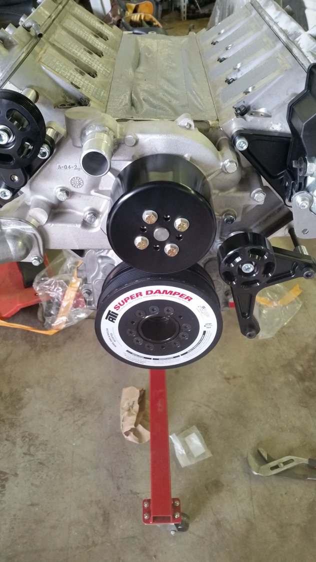

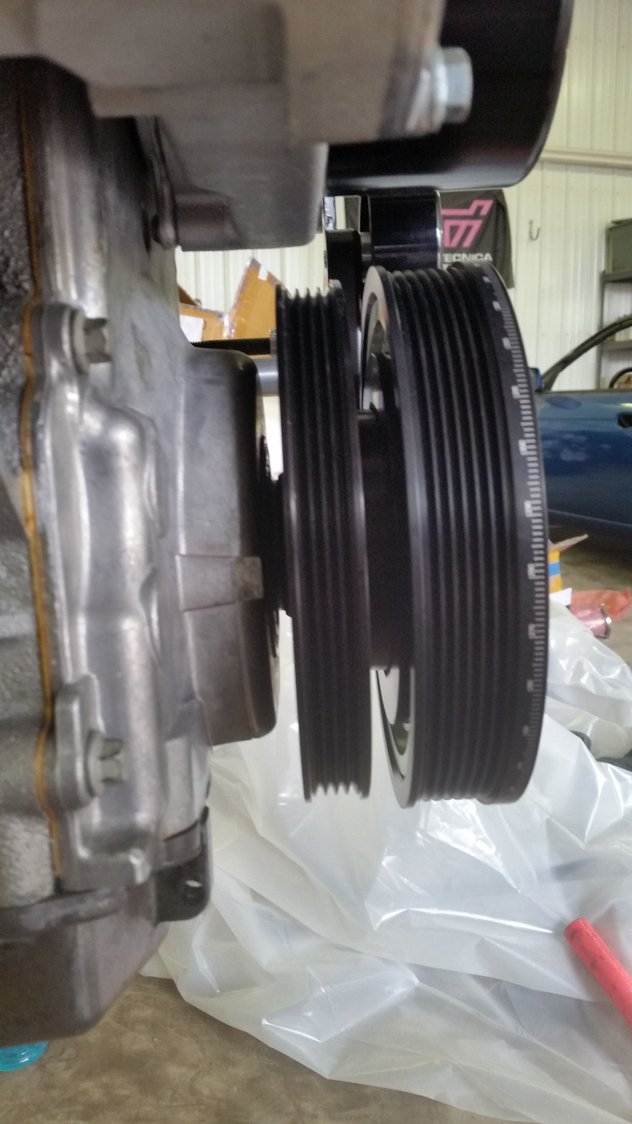

Quick run down, I got my engine back last week and started putting it together. I got the water and power steering pump on, tensioner, and alternator brakets on. I then started installing the harmonic balancer and noticed some very wrong. While the pulley is partially installed (nowhere within spec) it already does not alight with any of the accessories. Here are the parts I'm using:
Alper alternator and power steering bracket
Alper tensioner
Evans water pump
Ati harmonic balancer

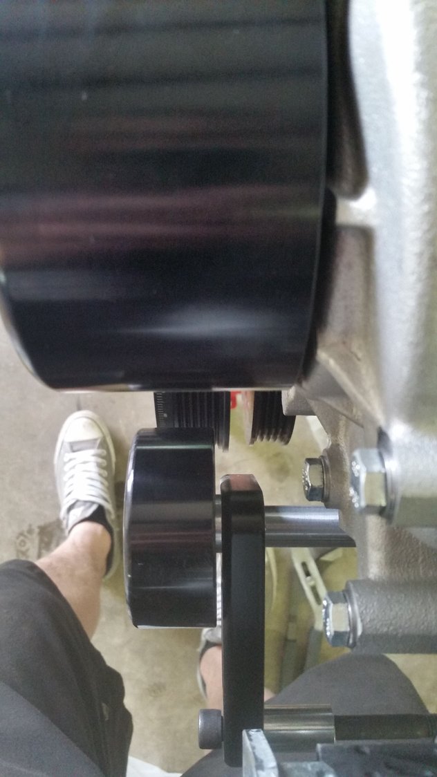

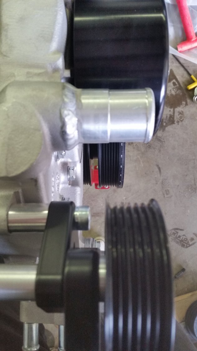

The pulley is still partially on, as I decided to wait in the event I have to pull it. I hope I'm not over reacting, but I'm looking for some advice. Do I have the wrong accessory drive, balancer or (hopefully not) crankshaft? Pictures:
Balancer
From idler pulley
From tensioner

it might be the Y body balancer, if so I can send you the other spacer kit, but we would have to swap out the power steering pump to the .250 thick,
the setup I run is a Y body and, the Front of the balancer where the ATI stick is, is 3.125 from the very front ati sticker to touching the oil pan, with F body it should be around 3 7/8 with the ati 6 rib,
Old Sep 9, 2015 | 03:53 PM
jalper's Avatar
Restricted User
iTrader: (9)
Joined: Dec 2010
Posts: 109
I just called ATI Yes you have the Y body, we would have to change out the Alt bracket to the wider one that kicks out the alternator to the side more to clearance the block, and to the short power steering bracket, the short power steering bracket needs to use the side tank from like a Chevy S10, and then the .250 spacers for the tensioner,
Or you can run Balancer ATI 917242 LS1/LS6 with AC,
Old Sep 9, 2015 | 04:10 PM
zac971's Avatar
Joined: Dec 2013
Posts: 10
I got messages from you both at the same time. You guys are awesome!
I went this route with the accessory drive as I am using a the turn one conversion power steering pump for a Nissan rack. The way I understood it from turn one, the pump uses a bushing that should only wear one way (as if it was on a F-body drive), otherwise it could see premature failure.
I'll have to swap pulleys, but I really appreciate the quick feedback. Total brain fart on my part.
