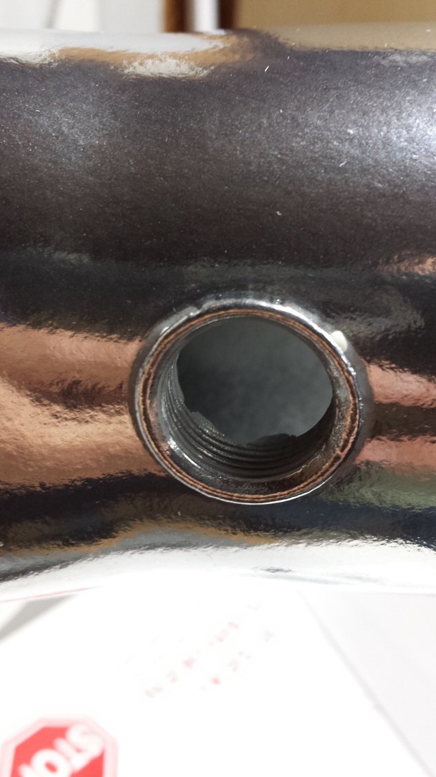

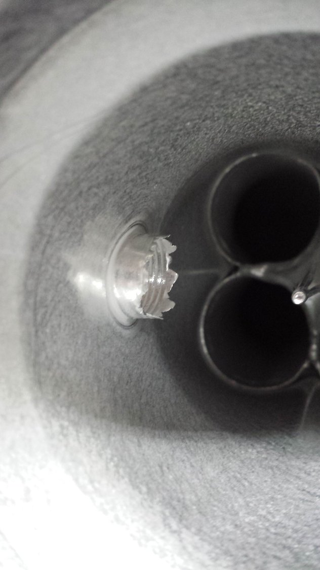

Some name brand headers have gotten cheap with their O2 bungs I don't know who's idea it was but, it wasn't a good one. See what you think. I would rather have a coupling.
This is a rivet nut.
Very thin.
