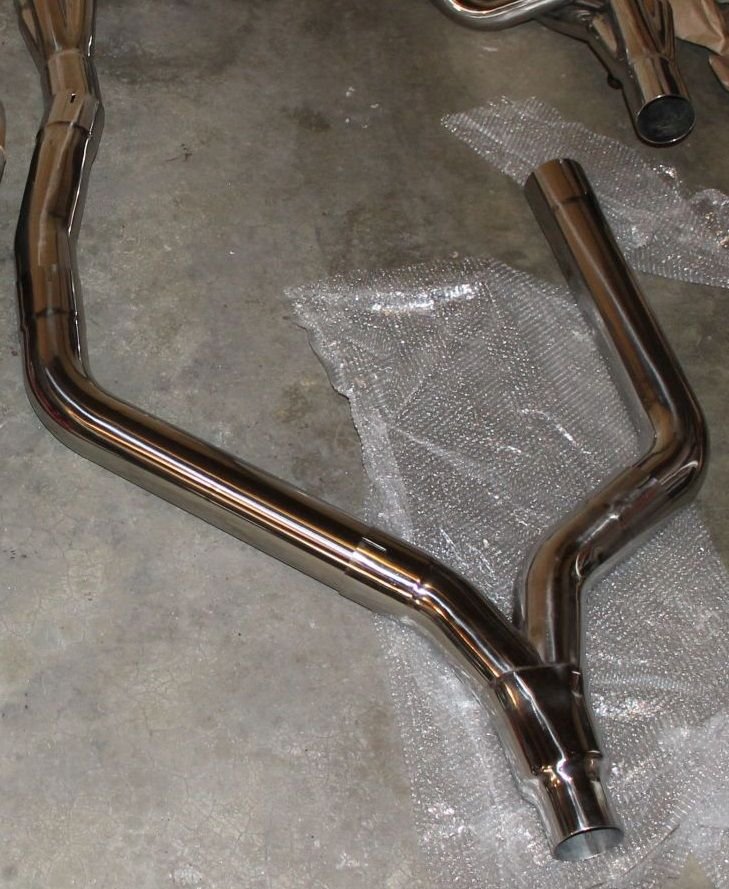

Here's what I wanted to post. In case you can take it off and need to swap anything.
Old Apr 25, 2016 | 08:11 AM
Rbernsdo's Avatar
Joined: Nov 2015
Posts: 38
From: Northern MN
Thanks for the picture, mine is set up the same exact way, the bottom of the car has spots where you can tell the exhaust should go, I wasn't aware that the cross brace won't be used. The cutting and welding was just stress cuts so I could get it to go over towards the passenger side more so it would tuck up into the tunnel without pulling on the headers. When it wouldn't move over far enough, I cut a hair off the length on the passenger side so it would pull towards the passenger header more to line the y up in the tunnel. I can make the drivers side tuck up perfect, but the y automatically lines up more with the torque arm than up in the tunnel. I'll try take pictures later out of the car. Do you know if any other y would fit up on top of the cross brace?

Nah, pretty sure all aftermarket Y-pipes require you to ditch it because they aren't flattened like from the factory. Check this post from the Sticky: https://ls1tech.com/forums/generatio...l#post13377443
The 2nd point on post 3 shows how the flattened factory exhaust is what allows the brace to be used. Mine's been gone since 2008 and the exhaust was only clamped together with no issues. I had it weleded a couple years ago so they could tuck it up nicely for me. I'm about to try and re-align my new TSP ORY cuz at the moment I only have 2.5" ground clearance with my setup.
I think I can twist that piece that attaches to the driver header and make it tuck a tiny bit more. Besides pushing pieces completely together or pulling them slightly apart like mentioned above, it's about the only way I can see any adjustment without bending pipe.
Sorry you're having trouble with it. My old exhaust (Pacesetter + old TSP ORY) went together quickly and so did the new one (TSP headers + new TSP ORY). I can't imagine why yours was/is off so much.
