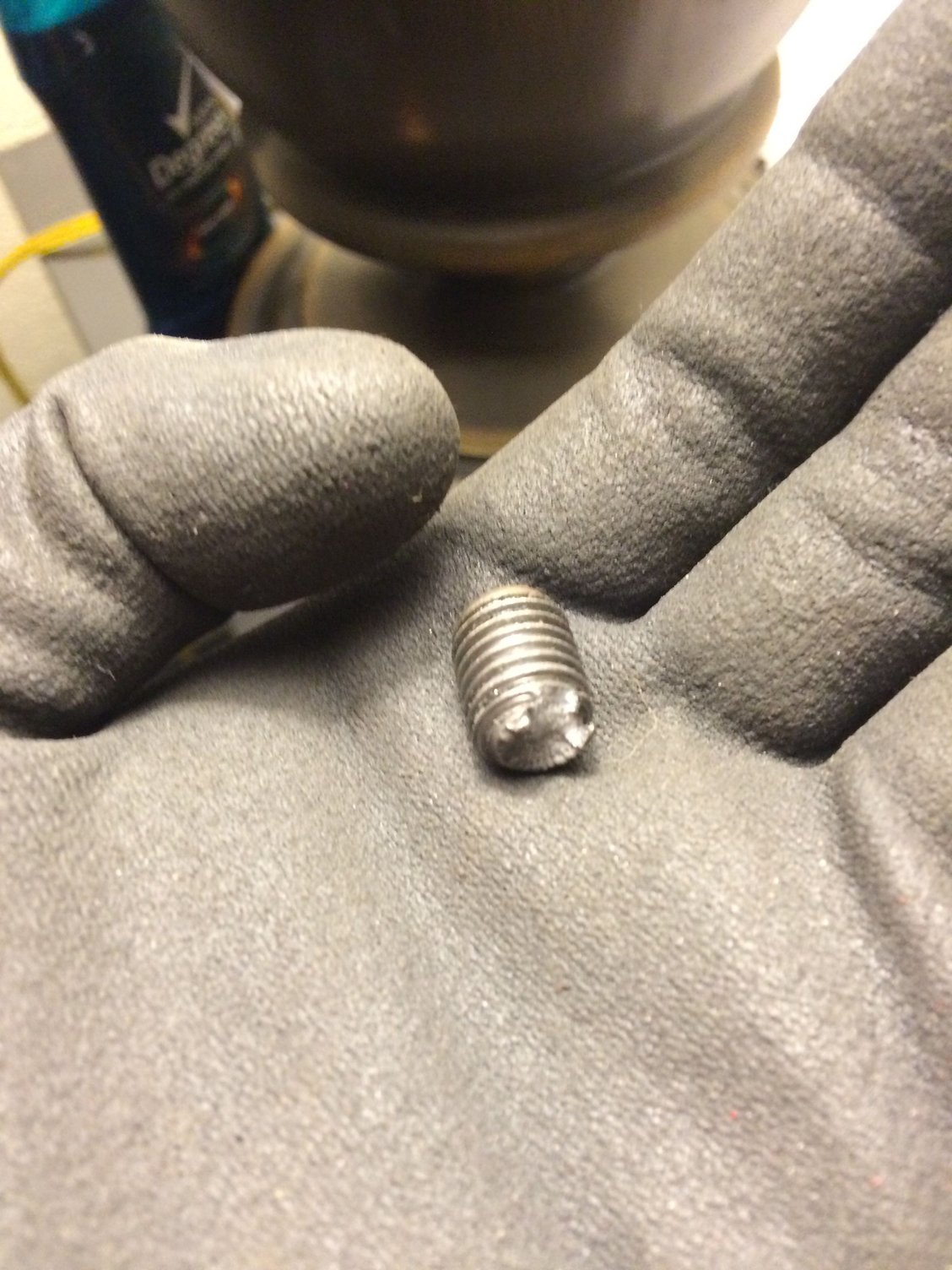

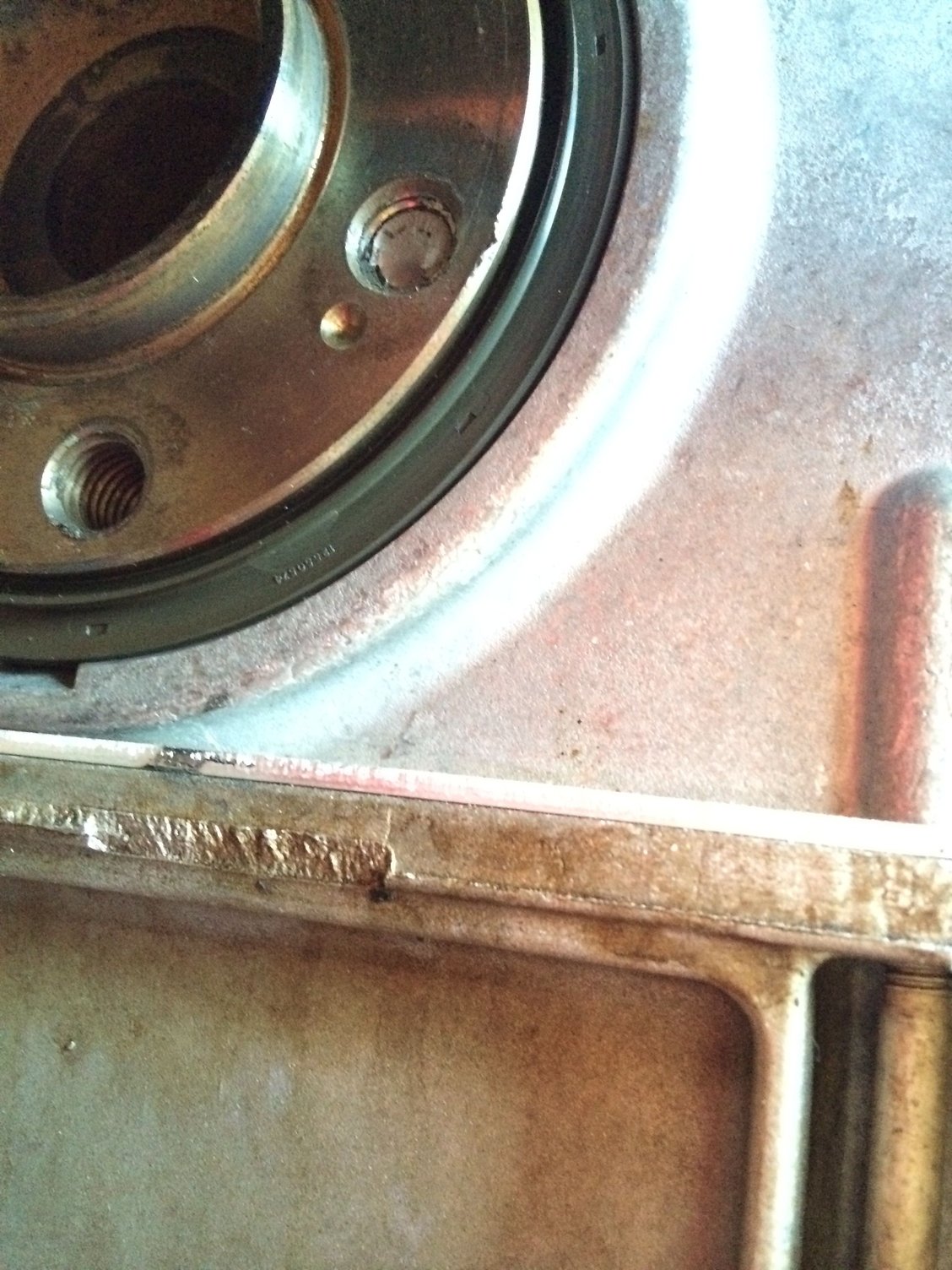

So I f*cked up and snapped off a flexplate bolt! I was using a torque wrench (craftsmen) I know. And felt the pressure release so I stopped and sure enough it snapped off idk if it was a defective bolt(reused stock bolts) but it snapped. I want some advice on how to get it out! Should I try to extract it out or drill it out myself. Or take it to machine shop, would they know what to do? Help!

Can't hurt to try an easy out or a screw extractor. I've found that a broken bolt generally comes out pretty easy if you can get a purchase on it. Once the head snaps off, there isn't any tension on the bolt end and it will back right out.

Center punch it as close to center as u can. Then use a left handed drill. It should back right out when u drill it.

Very important to get the hole centered, center punch it and start with a small drill. Getting it dead center is the only real trick.
Drill it deep with 1/8" bit then use a left handed drill of a larger size should back right out.

Be very careful when drilling and do NOT break a drill bit off in it, Once that happens it makes it a much harder fix. Just take your time.

Thanks everybody for the advice, I went to take a look at it again and turns out it had a edge to it so I used a screwdriver to chisel it out. I got it! Whoo! Got lucky.
