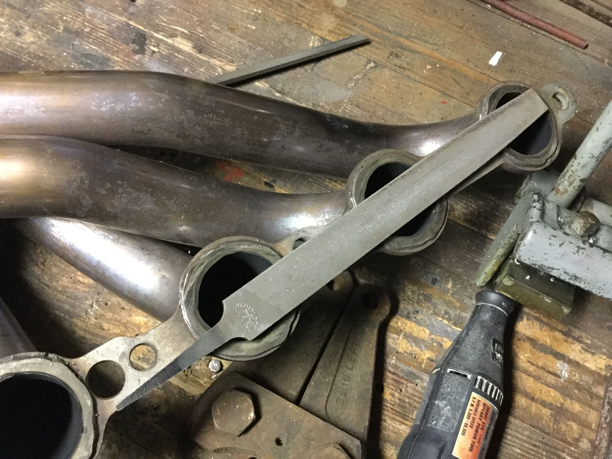

Ok where can i get long files? Would they flaten out warpage or just flash material?

Long files are everywhere, I've amassed at least 150 over the years. I find them at swap meets, garage sales, you can get them at McMaster Carr, sears, any home improvement store, machine supply company etc.
They will only flatten material, not a warp. I had to also use a press to get most of the warp out, but I caused some of that by the amount of welding that I did. But in any new header, I run a file so that it is at least in contact with 2 primaries at once, and it will take any small high spots left behind from the manufacturer cleaning up the inner primary edges. I marked all spots that needed material by looking where the exhaust leaks were in the gaskets. Some spots they didn't have enough weld so it didn't contact the gasket. I will try and get some pics here in a min to try to explain.
Some of the welds were to widen the sealing contact patch, most were to add material so it can be re leveled.

Back on topic, this is how I fixed my problems, a little effort and it's perfect, some bending, welding, and filing and it's perfect across entire flange. Choose your own path, good luck.
