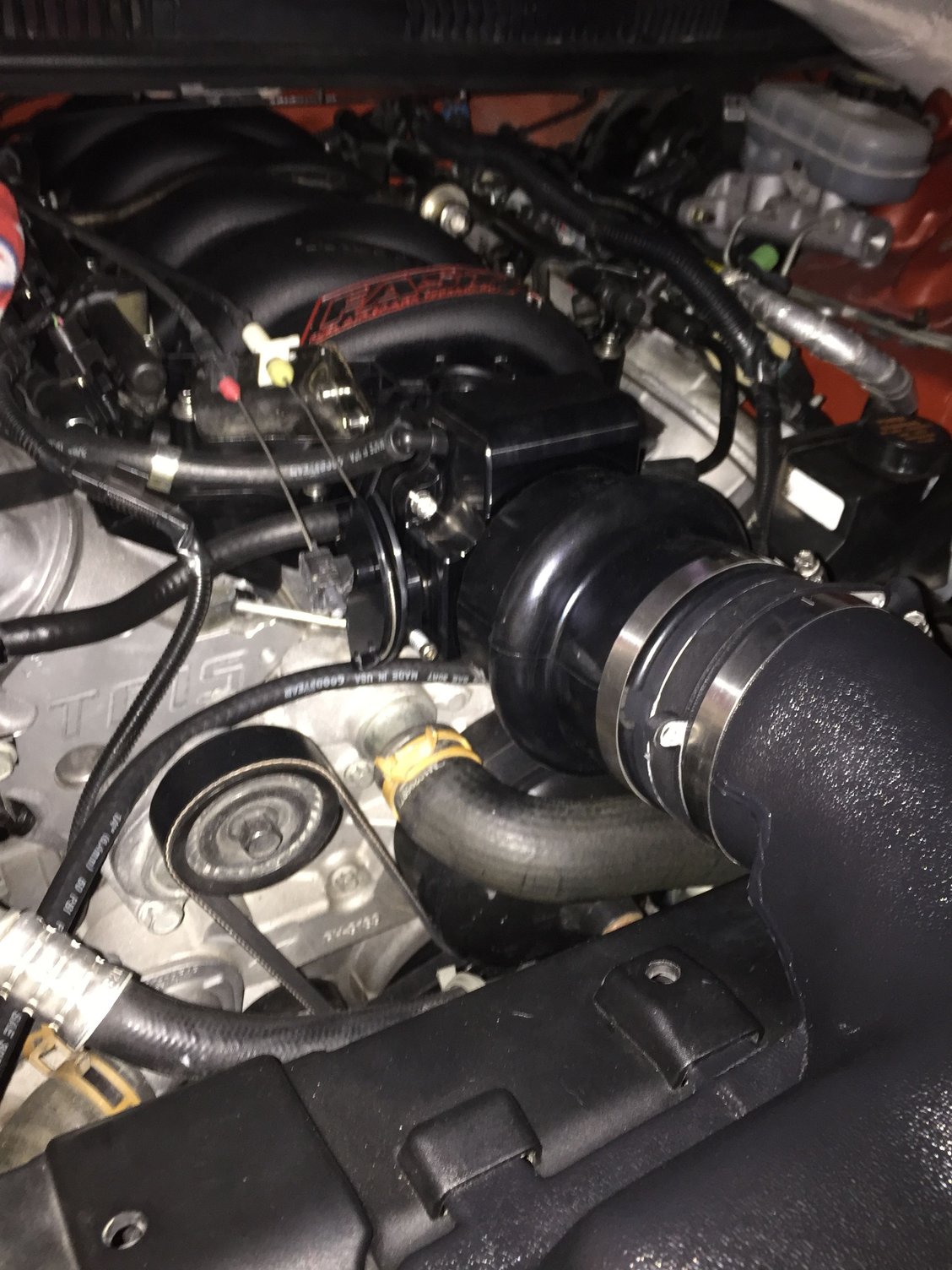

Well finally about done with my car, just need a tune now. Been having problems with smooth bellow to fit, it wouldn't line up at all with the NW 92, i also think solid motor mounts had a little to do with it as well.. So after some research, got with airflow systems and ordered a bellow, a little bit of trimming and its is as flush as it can get to on every connection.

Looks nice. What size lid are you using?

thanks. FTP 98mm

what sizing did you end up needing? I have a FTP 98 clear lid and fast 92 TB going in with my intake manifold swap this summer, haven't looked at bellows yet.

It was 4" to 3.5" hump hose from airflow systems. some people get the slp bellow to work, but there was no way this was going to work on mine. the slight bend they have jacked mine all up.
