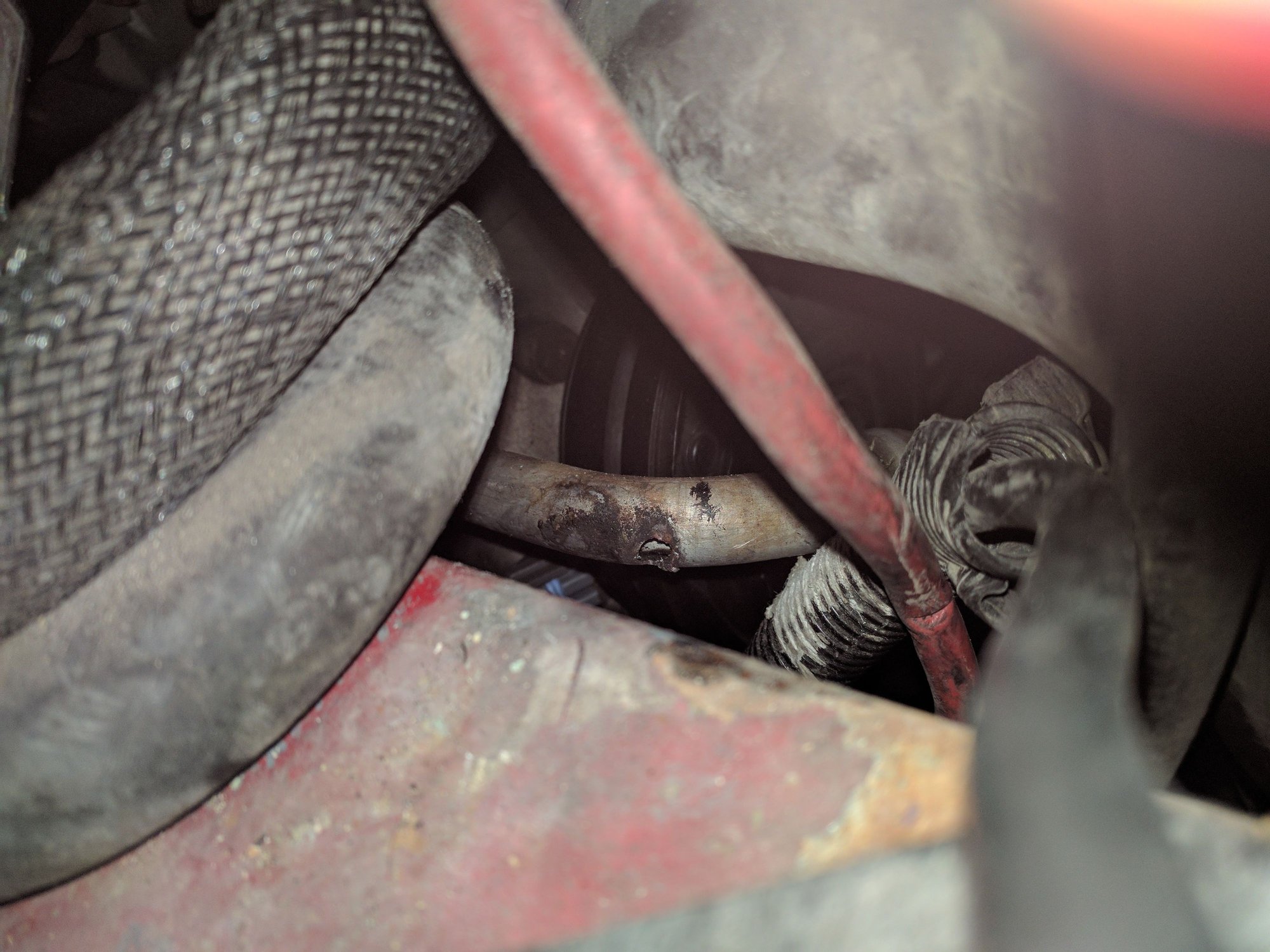

A few weeks ago my positive battery cable arc welded itself to one of the A/C lines. Its starting to warm up a bit here in Texas so I figured it was time to replace the line. Is 19213715 the correct part number for the line pictured below? What other components will need to be replaced as well? I've read that the drier should be replaced since the system has been open for an extended period of time. I figured I could replace the parts and then have a shop do a full service on it. Thanks for the help.

Looks like the correct part number. #10. It would be a good idea to replace the drier. The line should come with seals needed. New end seals & seals for the block on the compressor but I'm not positive. Maybe just do the line & bring the new drier to the shop as they can slap that in before the service.
