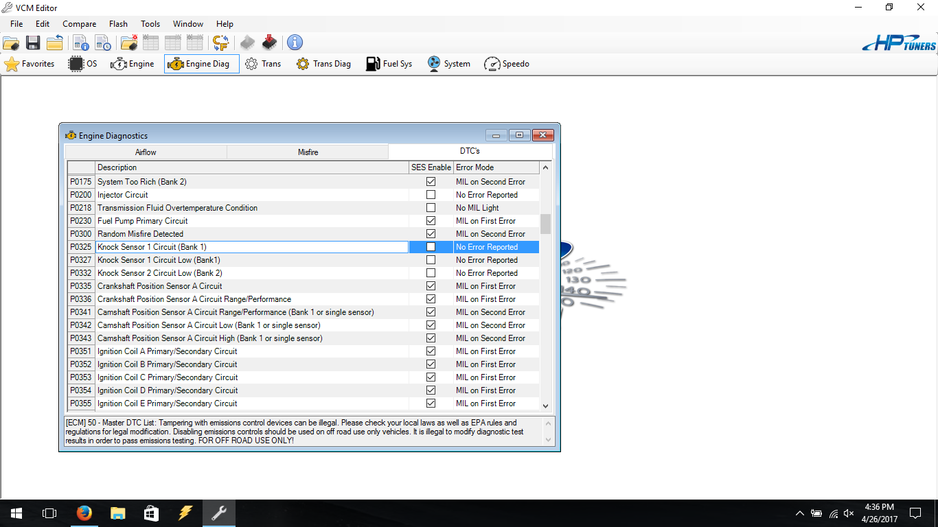

Where in HP tuners did you tune them out? I have the same thing Happening. 80kpa and it pulls 5* no matter wat. I know I can lower that value but I heard with things like headers etc u just need to tune down the sensitivity so they can still pull timing. I'm boosted so knock is bad for me.
Can u post screenshots of the tables and values? Or list the tables and the values u used?

If you disable the codes the sensors still work, possibly not as or maybe more sensitively they just don't pull the timing as soon as PE hits for the code. I'll take some shots in a few mins.
