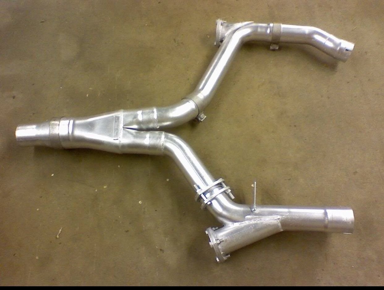

This is a picture I saved from the forum.
Looks all custom with that flow master merge at the end

Looks pretty sweet. I would like to have a Y pipe like that for my 99 TA.
Adding a pair of electric cut outs for extra fun?

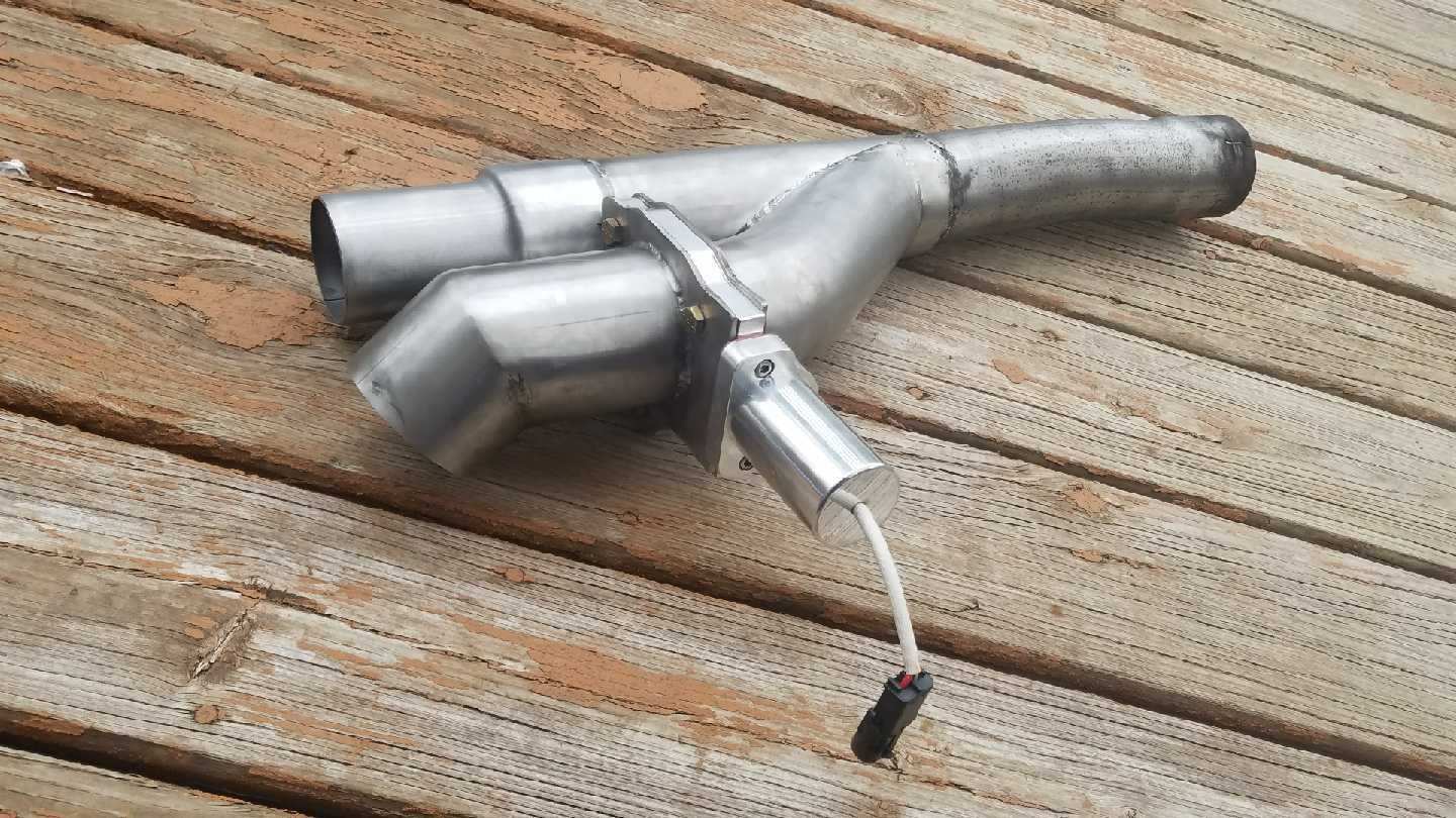

I do not have duals but here is mine in the I pipe.
Remote controlled electric cutout.
Cut out a chunk in the I pipe, have it welded in, bolt it back in.
Having duals after the collectors would be so damn loud lol. Start your car with Lt's only.

Bad 408 vert that is the style I have seen before but it looks like everyone is just doing custom stuff for cut outs
