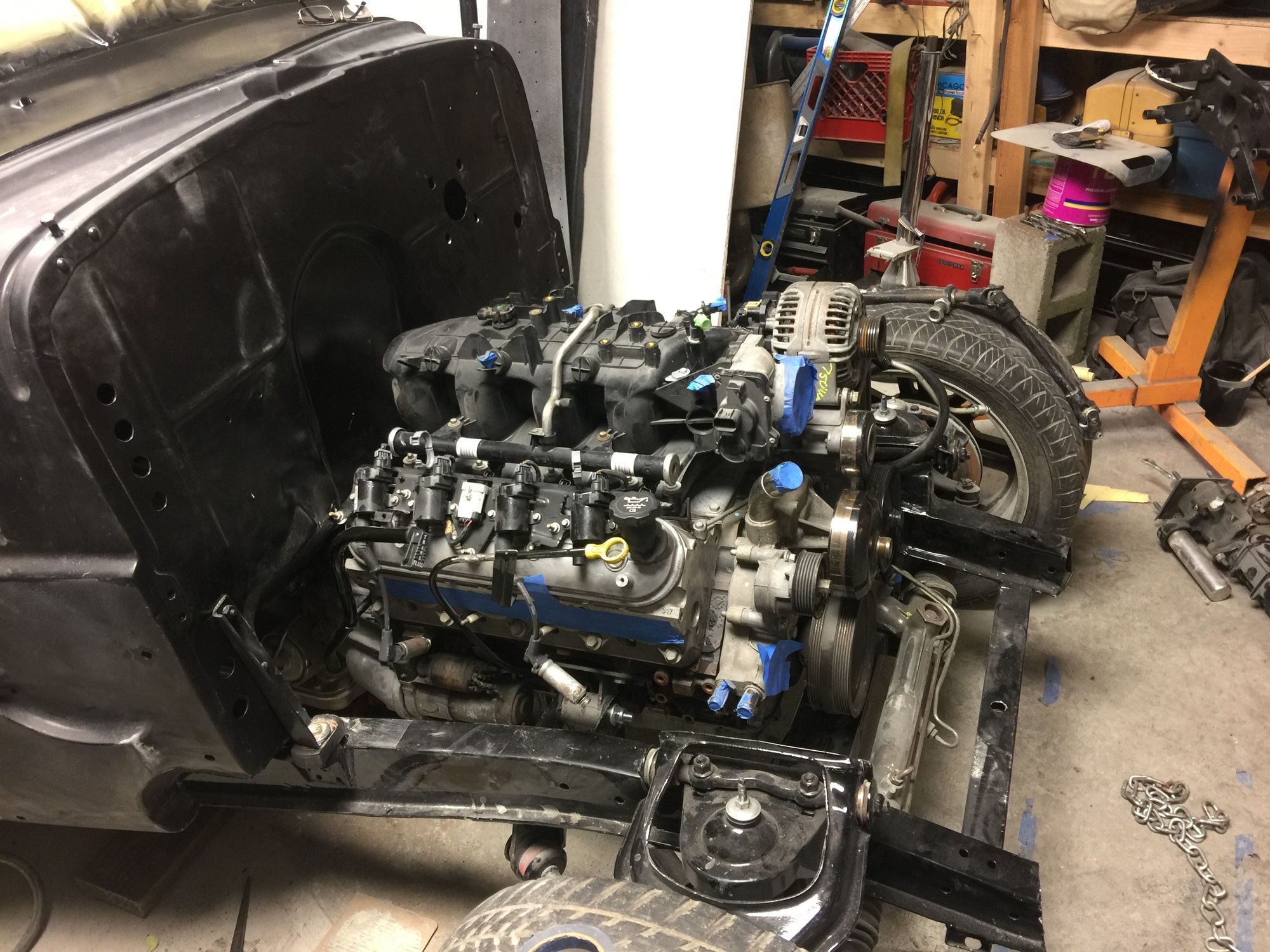

My question is my frame to exhaust clearances are so tight I can only get block hugger headers to work 1 5/8 " with 2 1/2" collectors ?

With the stock manifolds the flanges are hitting the frame

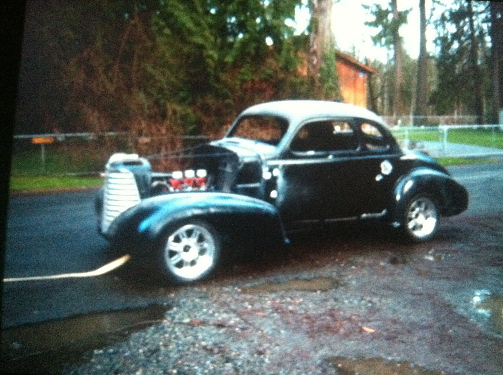

I've already done that when I went with a 327 small jernal crank that's in the pic I had it running then decided to go with a ls motor and had to redo the whole drive train and replumb every thing .

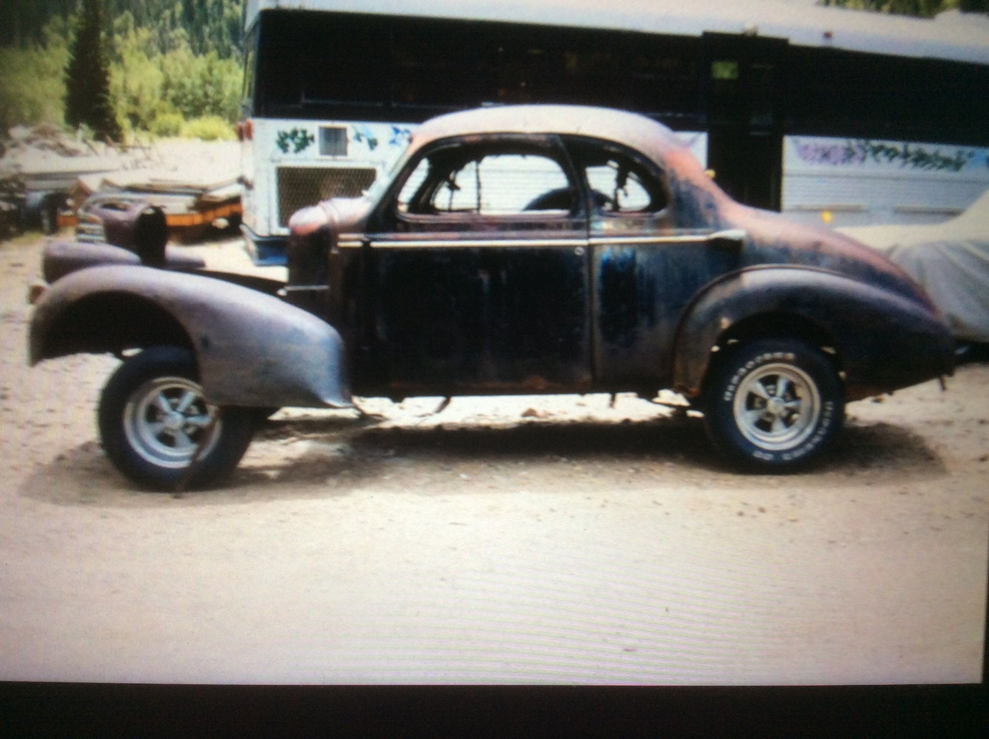

This is what it looked like when I got it
