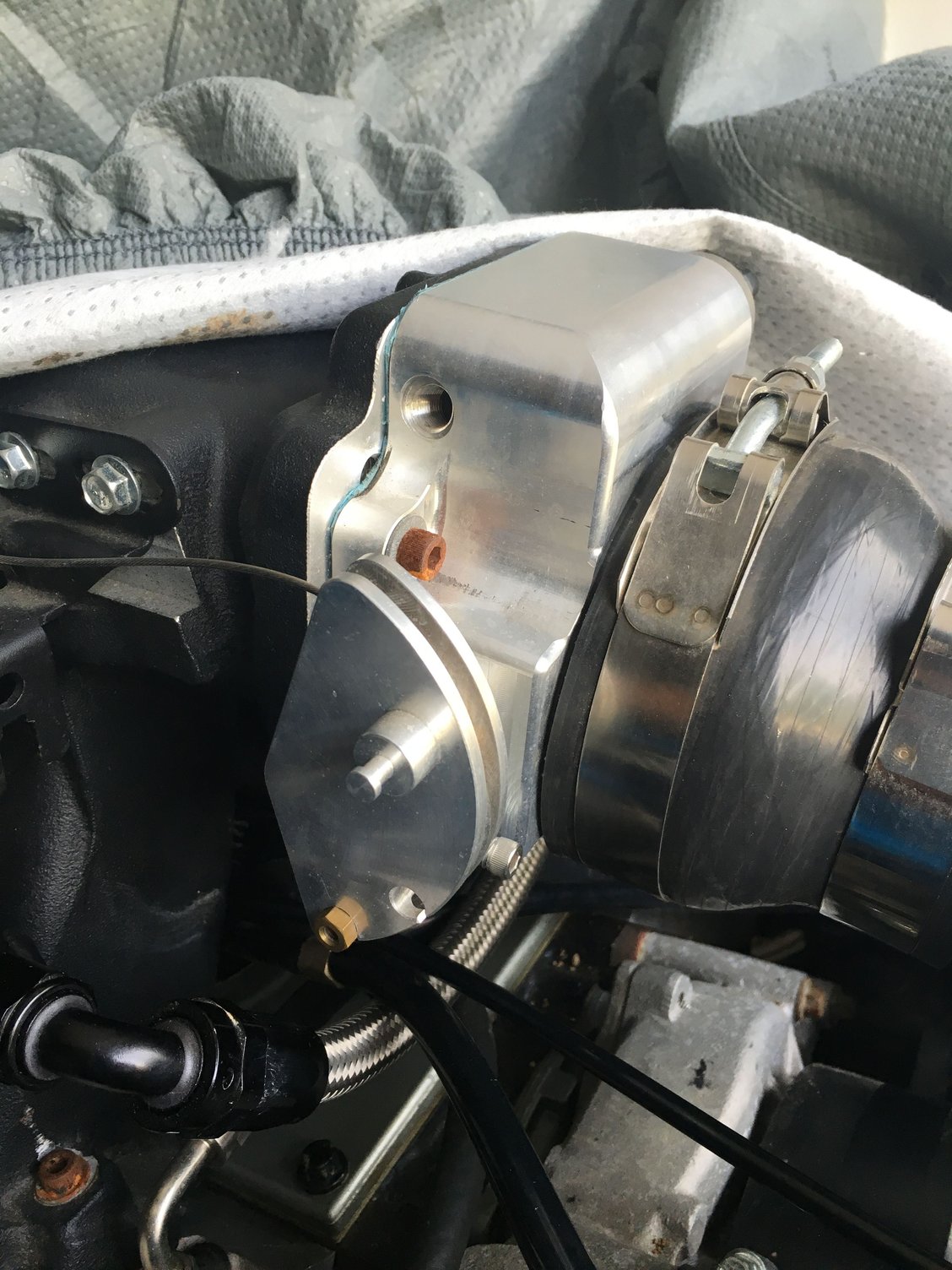

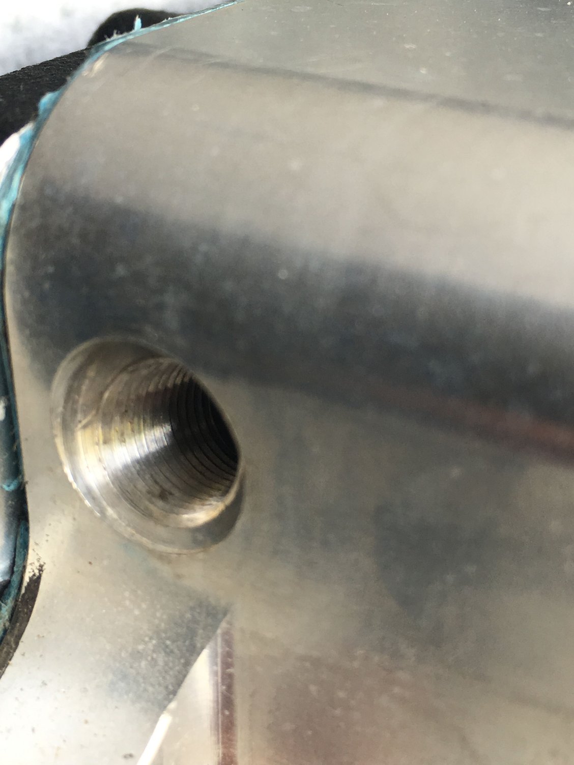

Quick and stupid question here guys... Can anyone tell me what thread size this is on the side of the TB? Where's the best place to get the fitting?

You can probly find it on Earls plumbing but the best thing to do is call Nick Williams or WS6 Store to see if maybe they can do some research for you. I have one on order as well, I can run to Home Depot and find out the size and thread for you. Lmk know send me a Pm so I have a reminder.

They are std npt thread either 1/8" or 1/4" cant remember at the moment but i think its 1/8" from memory. you can use any brass fitting for it straight or elbow but make sure to use either thread sealer or rtv on it.
