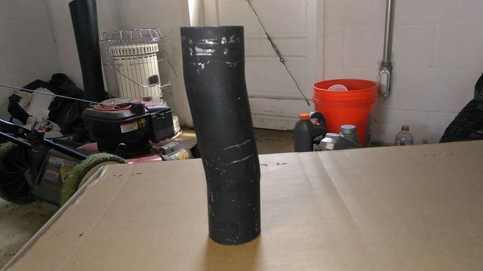

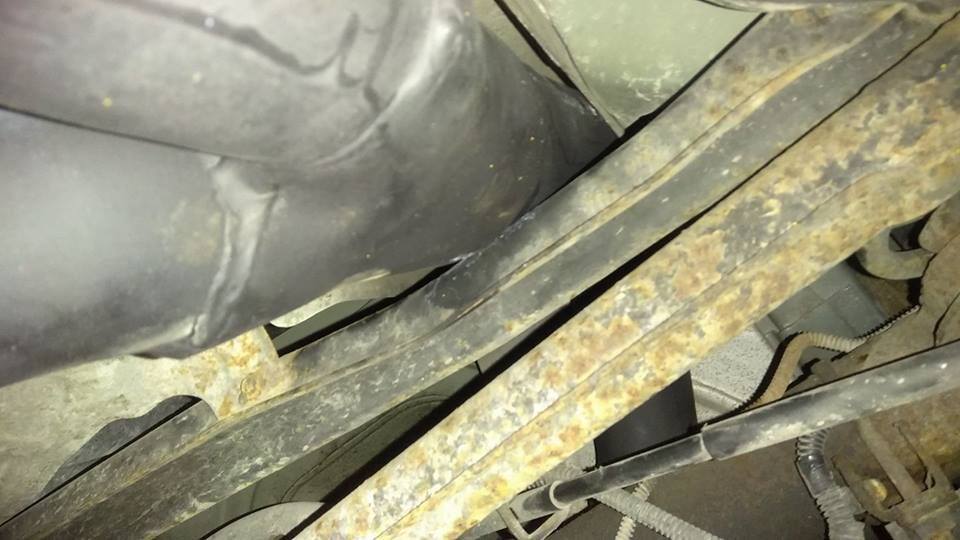

having a little issue with my SLP Loudmouth exhaust, no matter how I adjust it seems to keep resting against I'm taking that is the panhard bar(2nd pic), SLP has a small pipe that goes between the Y pipe and bullet muffler(1st pic), anyone who has this system, do you know which way this pipe gets oriented? (It looks like this is the only pipe that could affect how the whole system goes.)Thanks

would getting a Founders panhard relocation take care of this issue?

I just put the SLP LM on mine last weekend.
It took me a bit to get it fit and adjusted right.
it will take some moving around to get it fit right you juat have to mess with it some. That pipe depending on which way it's turned will keep it away from the driveshaft. Mine is a good ways from the panhard bar. The only thing that I didn't like was the elbow pipe that is on the backside of the bullet has a little too much bend in it and it lets the bullet hang lower than I would prefer.
i have messed around with it some and still can't get it the way I want. It doesn't drag now but I'll just have to live with the way it is
Yes if you aren't wanting to mess with adjusting it anymore the panhard relocation would give you the extra clearance you are looking for.

That small pipe needs to be orientated so that it points upwards towards the muffler from the Y pipe outlet.
