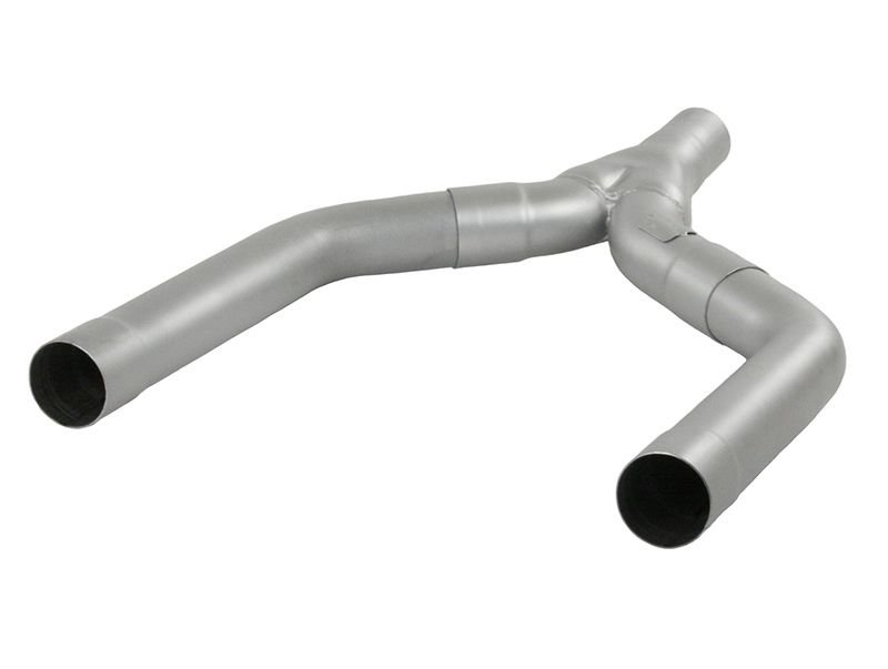

02 TA A4 Pacesetter LTs, old design Pacesetter ORY, 224 cam, Yank 3600.
So with the cutout open the rasp is pretty awful. My current plan is a TSP catted Y, an their new 3" catback with cutout. Im pretty sure this will fix the rasp. But I was wondering if anyone has any experience with Pacesetters redesigned ORY. That merge looks way better than the old one.
Link to the one Im talking about.
http://www.ws6project.com/user_stor/...oducts_id=6941

That merge does look good, but when in doubt, just get a Flowmaster merge of the correct tube sizes, weld it in, and problem solved. Probably the best merge in the biz.

You can get a flow master merge and replace the merge in your current y pipe instead of replacing the entire y pipe and still have the same out come / result.
Whats the current catback you have now?

that looks like my old TSP Y....it fit like S H Y T E

Yep I added a FM merge to my old Pacesetter ORY. Made a huge difference

Stock catback with a cutout welded in.
Ive done some reading the last couple weeks and the FM merge kept coming up. So that may just be the route I go as far as the Y pipe goes.
