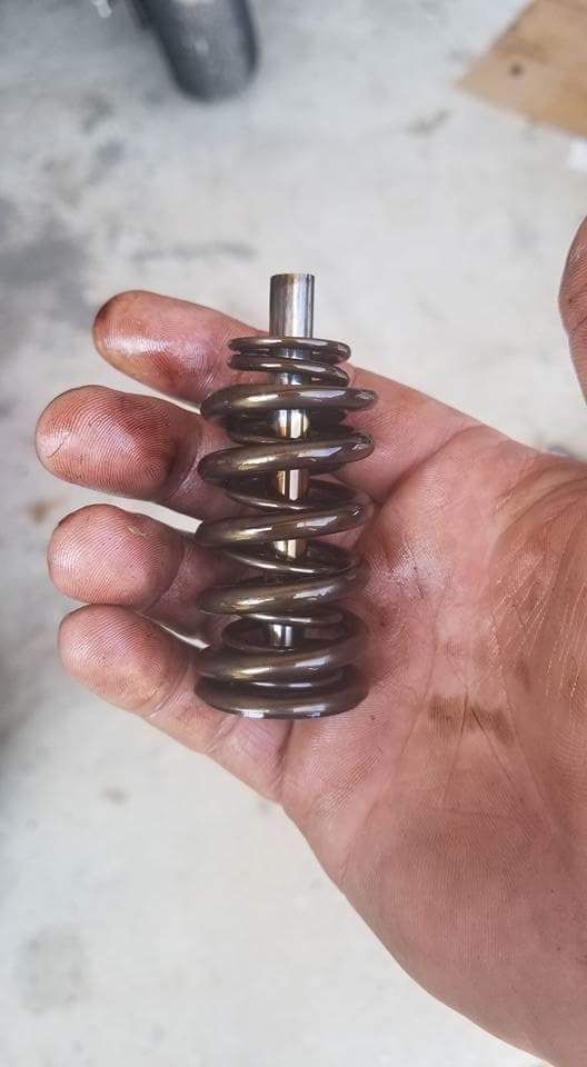

Its not that plenty have done it its that all those nascar engines run them. every single one.
A dual doesnt give you the safety blanket youd think. Ive seen both fail and both cause issues.
This happened a month ago.
In not begging you to buy beehives, but the idea that a dual will save you if one spring breaks is not entirely accurate.
Now it IS a way to get more pressure...but on a TI valve you dont really want alot.
