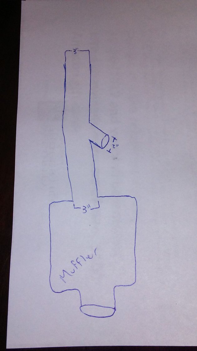

Comparing cutouts. Would there be a gain if I go with a 2" cutout on a 3" single exhaust system? I see cutouts are 3" y-pipes with one of the ends routed to bypass the muffler. My idea is a cutout that has a 2" to bypass the muffler. Would that bring any gains in flow? Below is a drawing for reference.

WHY would you want the cutout to be smaller than the exhaust system in mind?? Unless you do not want the full gain to be had with a cutout..... (smh....)

You want at least a 3" cutout. 3.5" or 4" would be even better

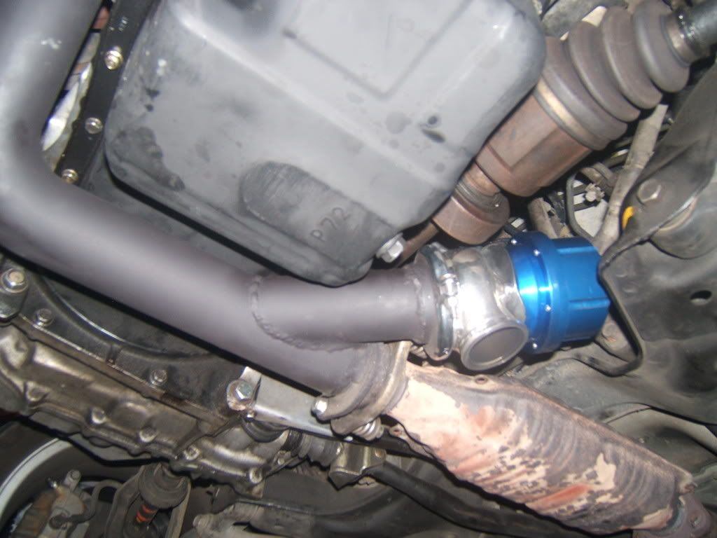

Im looking to use an external wastegate and have the cutout open by boost. So my main concern is would a 2" cut out gain me anything vs having the original 3" exhaust. Looking for a set up similar to the pic. Wondering how good this would be vs my current 3" exhaust that has no cutout.

Basically you will have a controlled leak. Do not expect much gain from a 2" leak in the pipe. Sure, something is better than nothing, but not worth the expense of a wastegate just for a 2" hole in the pipe.
