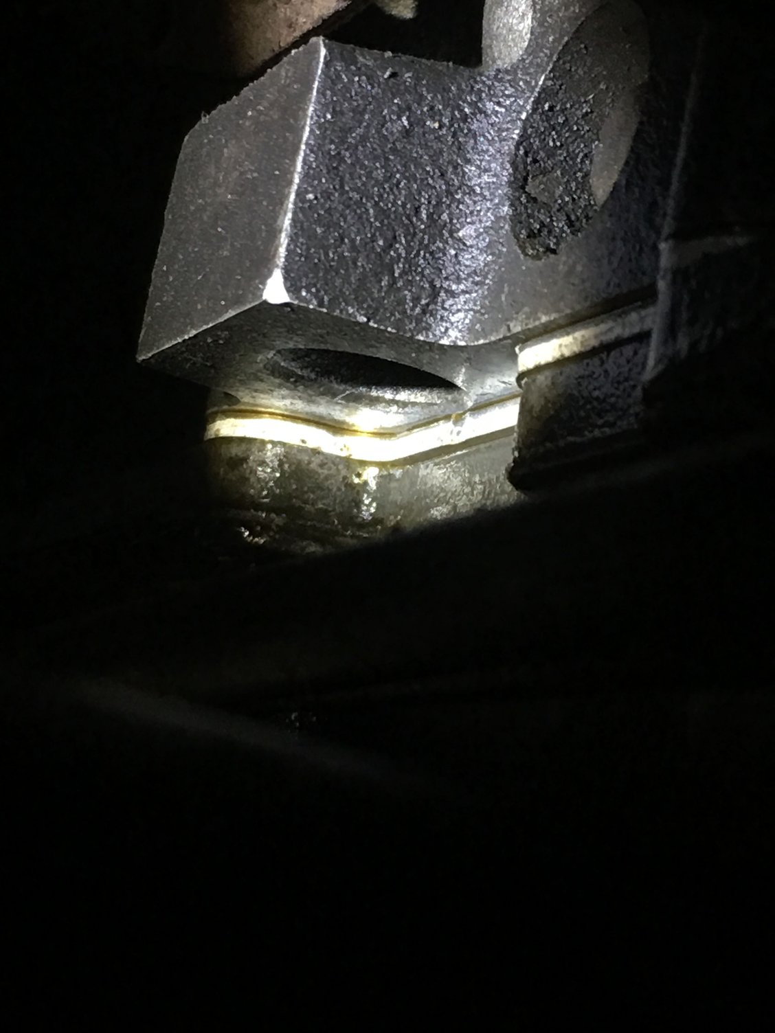

Just got the gasket replaced a few months back. Looks like I'll be giving them a call if it's really the pan gasket

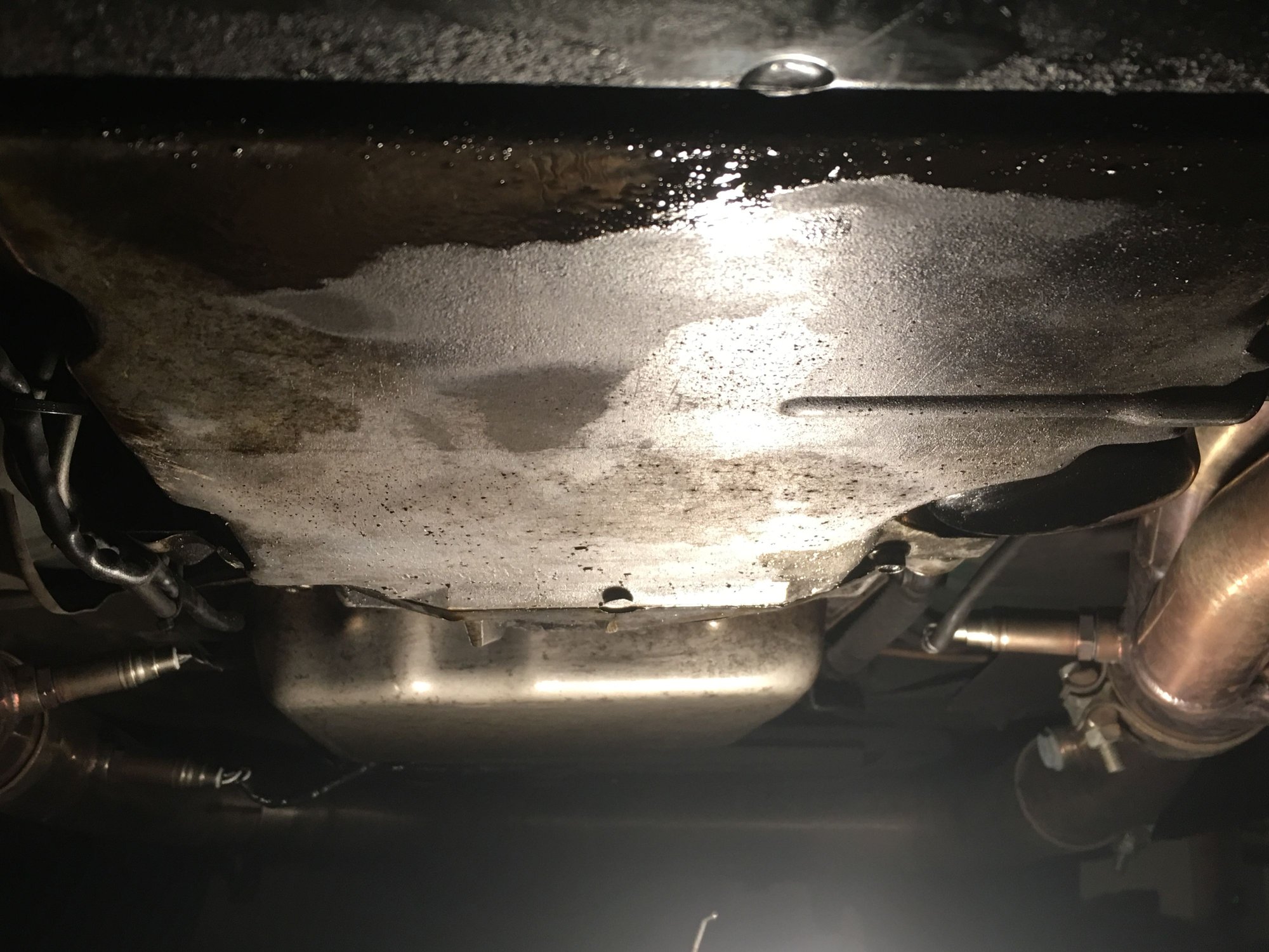

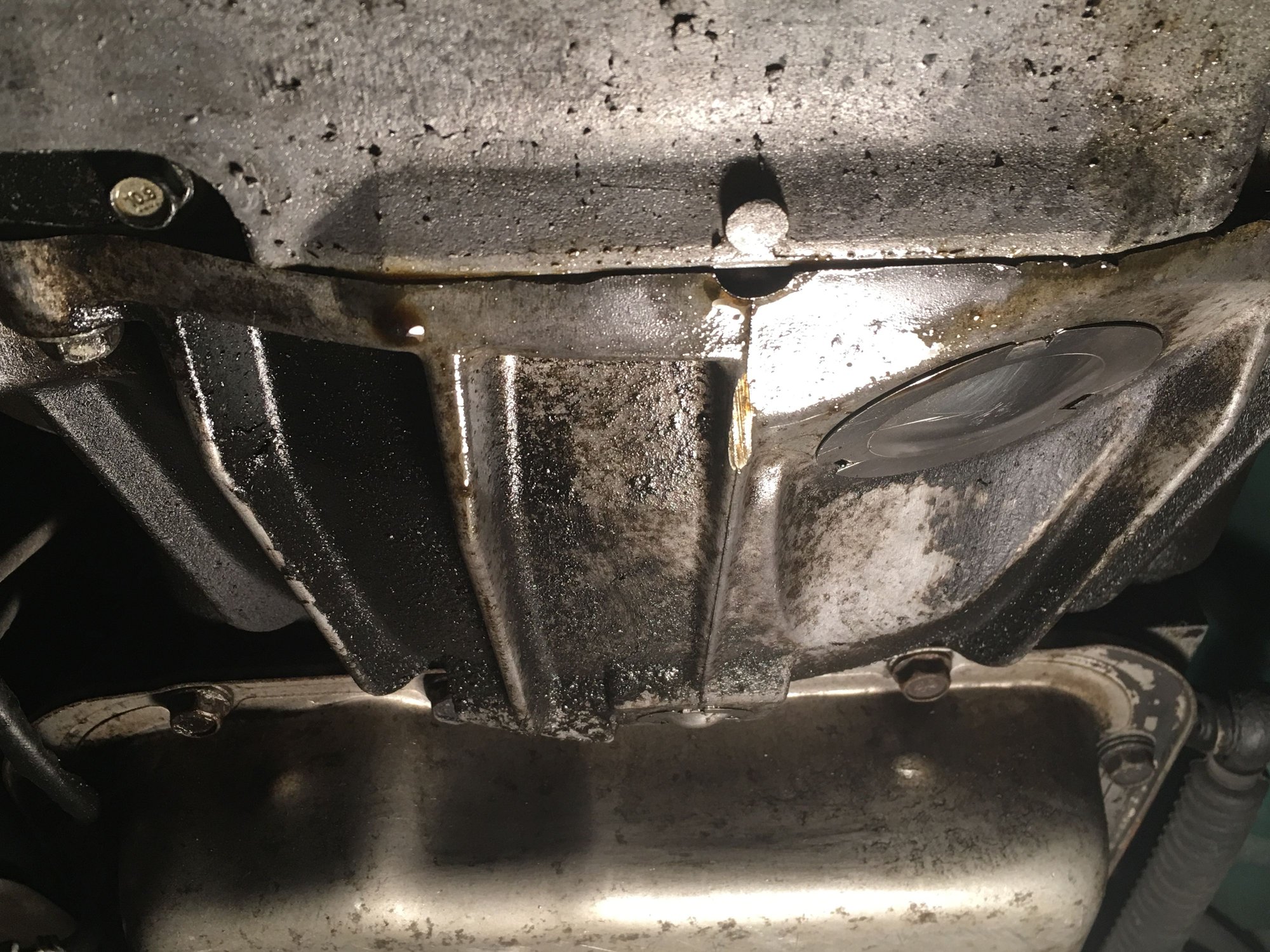

can be one or more of the following:
- engine pan gasket
- engine rear main seal,
- engine cam sensor o-ring (LS1/6).

Try torqueing the two long pan bolts in the back that go into the rear cover. They're low torque, 107 inch/lbs I think.
