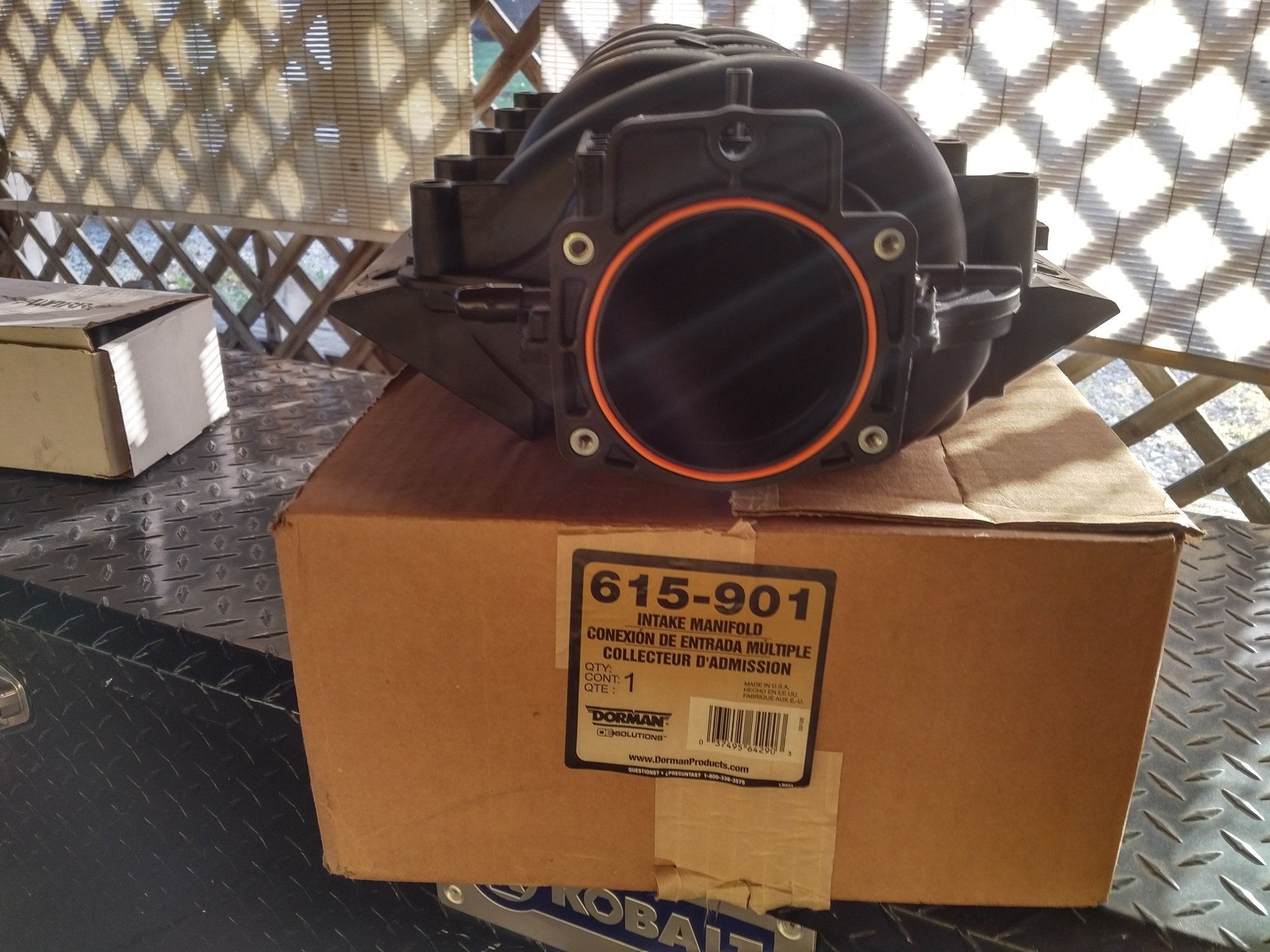

The eBay add is most definitely IS NOT an LS6 90mm intake manifold. That is a Dorman LS2 intake manifold part number 615-901.

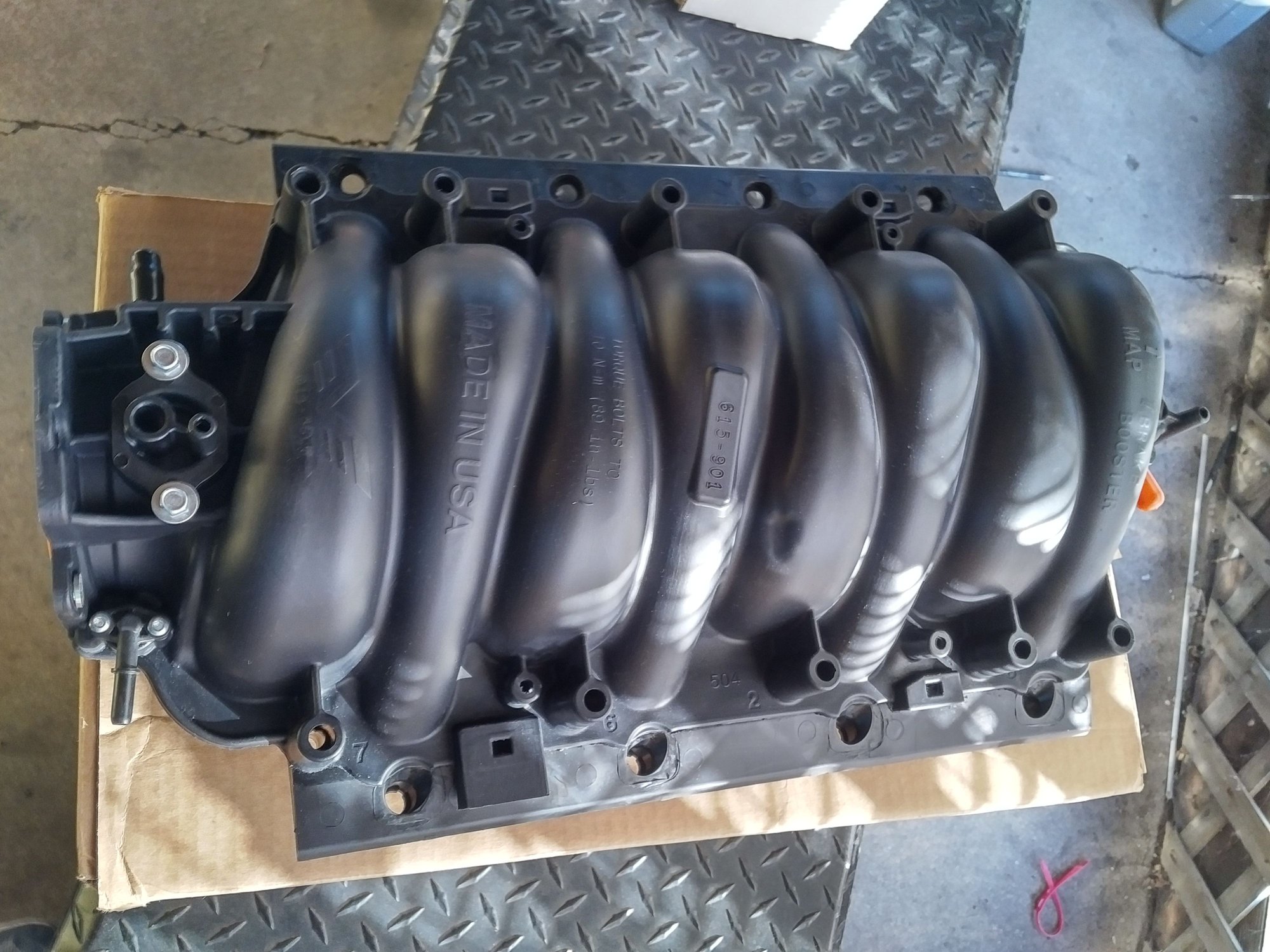

My old Dorman LS2 intake used for flow testing.
Top of Dorman LS2, note there are details different than an LS6

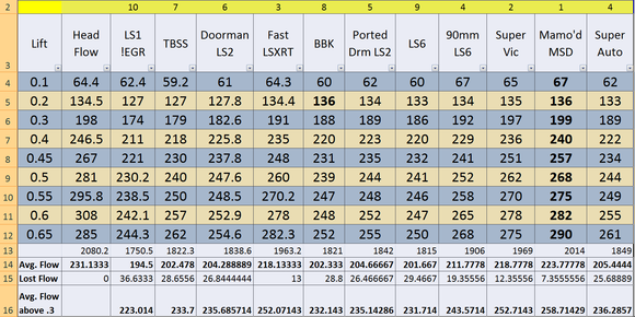

My flow test data using the same ported 243 head. The LPE/TPiS LS6 90mm intake manifold out flowed the Dorman LS2 & ported Dorman LS2 manifold.
