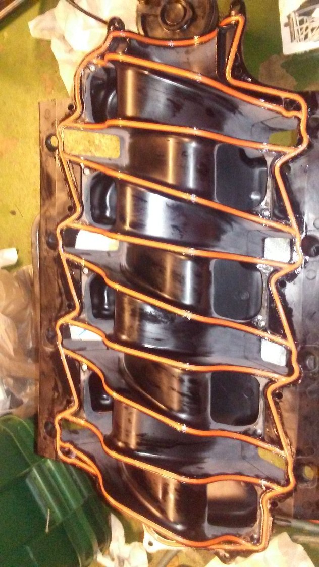

Took apart my F.A.S.T. 92 to clean it and i have a question...
I have the seals and hardware but I'm not sure if there was anything sealing the inner runner section to the base. Does it just lay in place and the rope seal gets installed on top before the upper section is bolted on? When i took it apart it seemed to have silicone around the intale ports between the base and middle section. Is this how its supposed to be put back together? Thanks .

Maybe this will help...Pg. 4, or maybe even the parts list might help:

there was little silicone dabs on the ends where separate rope strings met....when i took mine apart to port it i could not get the old rope seal back in for nothing !! I ended up buying a new seal kit .....best advice to give ya is to cut the seals a little longer than needed ( not to long ! ) and get some dielectric grease and lightly coat the rope with it ( not to much ! ask me how i know..... ) the grease highly enhances sealing and makes for smoother joining......be sure to cut the smaller pieces at the angle of the adjoining end
