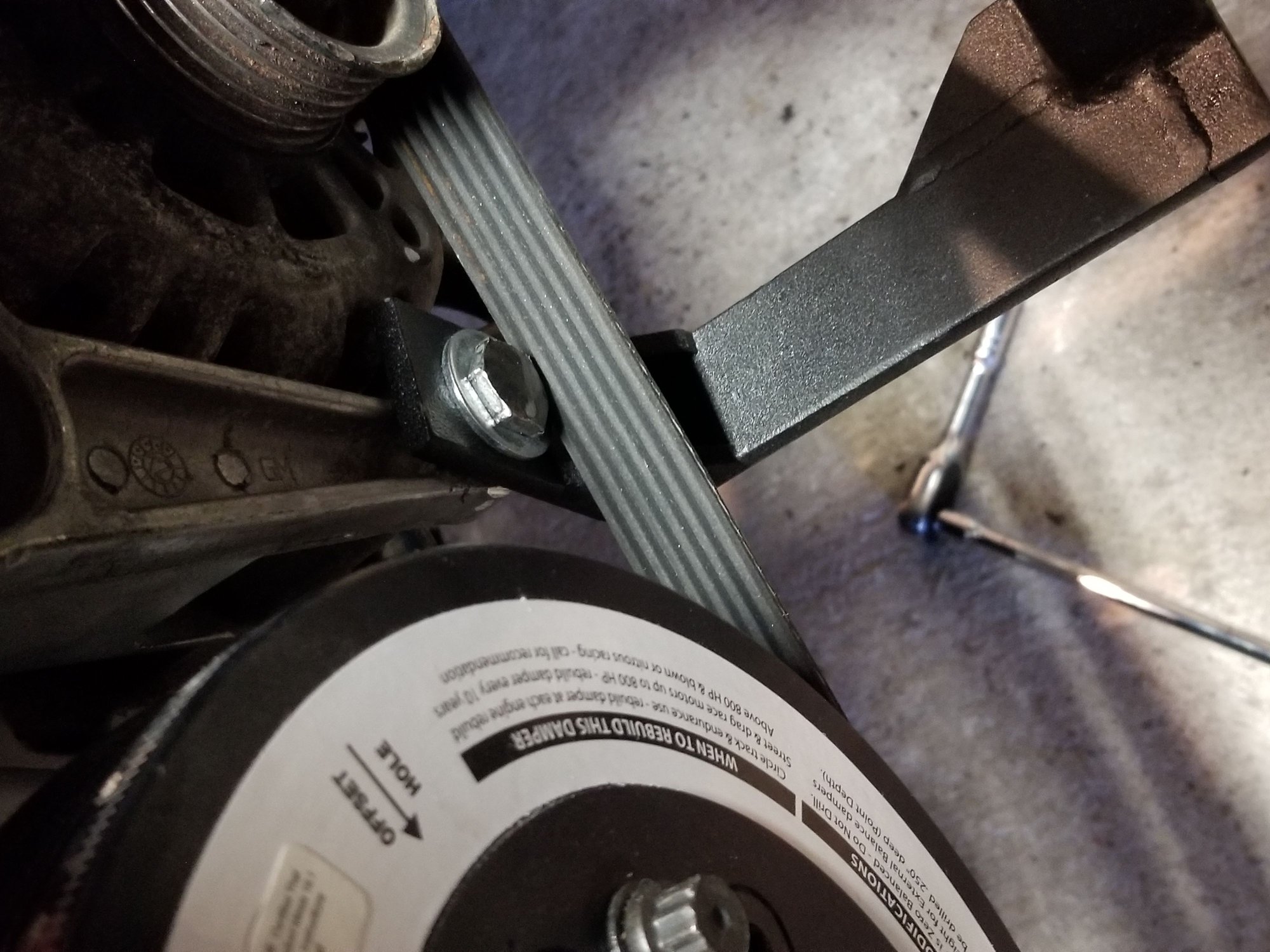

Hello everyone, i was wondering if anyone could give some advice, my belt is hitting my lower alternator bolt head i ground down the bolt head a little to clear it and it worked until i put my huron speed oil drain/ turbo support bracket on then same thing any advice? I suppose i could grind down the alternator bracket and turbo bracket a little but in for advice first, also running a katech belt tensioner and ICT power steering delete pulley/setup if that helps any.

Your new damper is too small. The factory clearance was already tight and for you it's now gone.
Easiest solution is a button head bolt if you can find it in the right size. That may buy you just enough room without having to touch anything else.
Other option is to swap on a larger diameter alternator pulley. That will require a longer belt, but it'll get the clearance closer to factory.

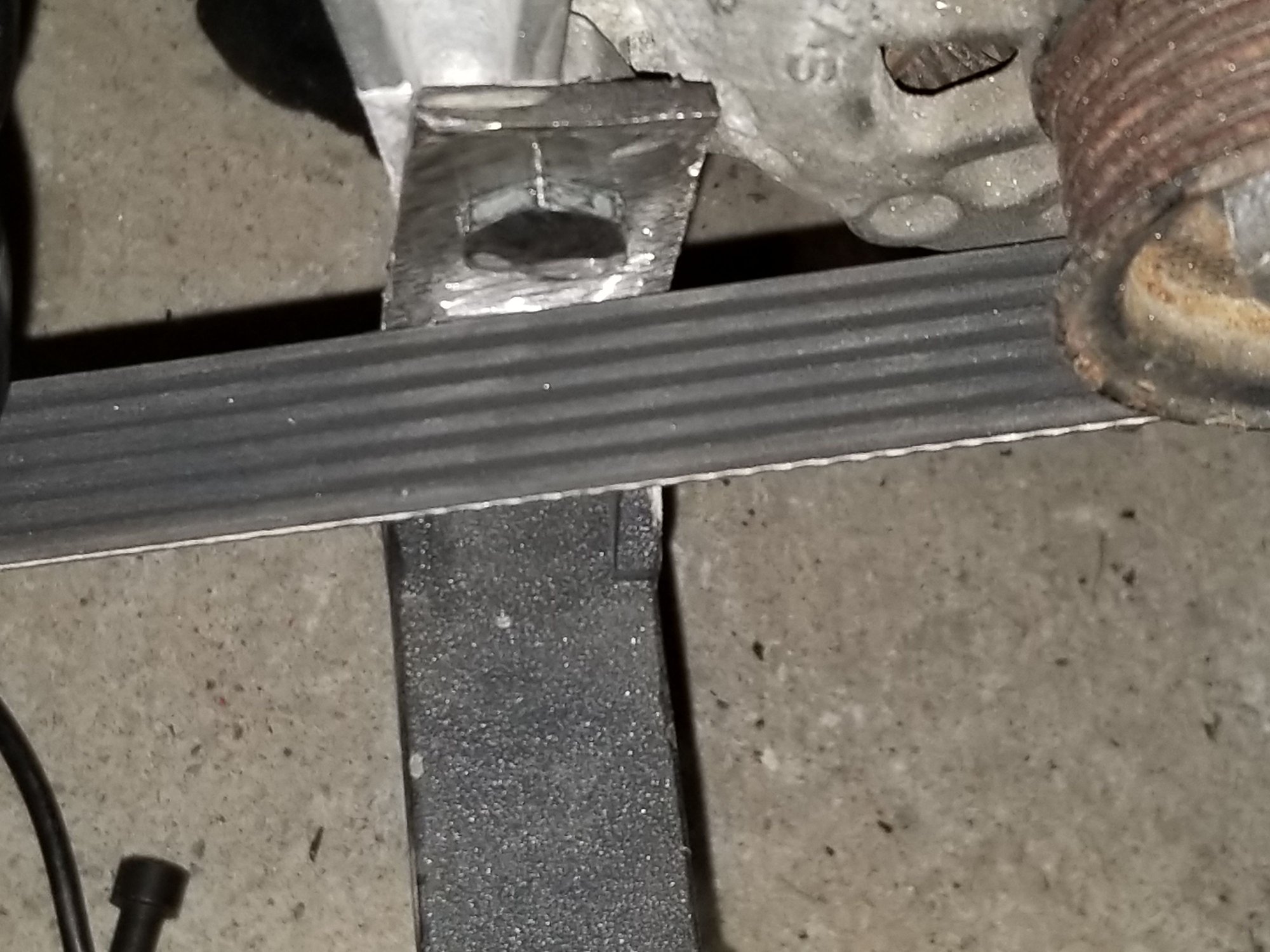

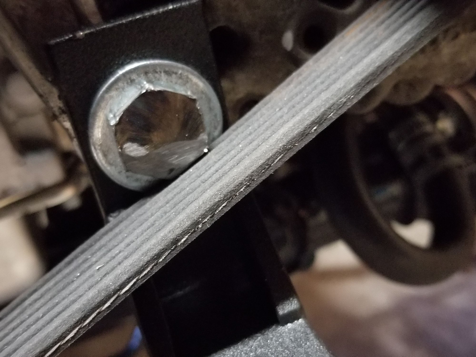

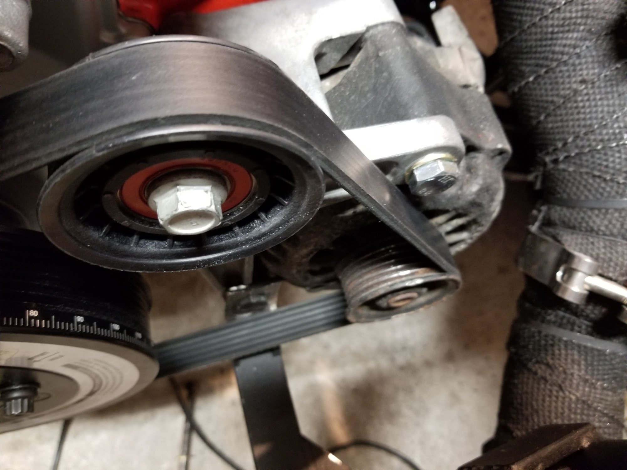

Just posting a update on this in case anyone ever runs into this issue, went to several hardware stores, ect. Couldn't get a bolt in that size except regular and socket head bolts so i just ground down the huron speed and alternator bracket some and ditched the washer as the bracket is tight on tbe bolt, it cleared fine now. Sorry for the crappy cellphone pics i took them before I took everything off to paint. ​​​​​​​
