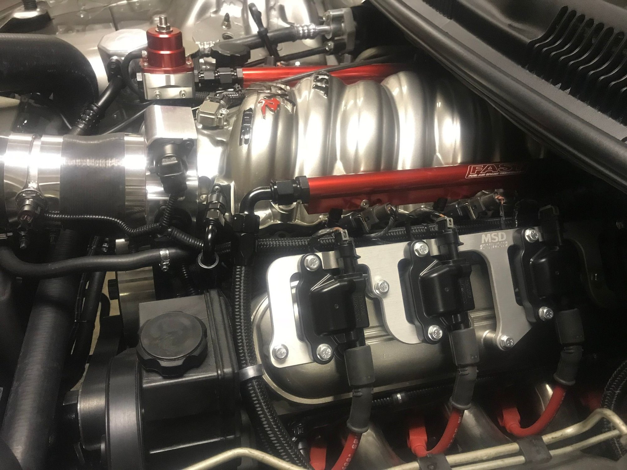

Does anyone make an aftermarket LS2 Gen3 coil pack harness that works with the stock coil location on the valve covers? I have only found the OEM harness (Ugly) and the coil relocation harness's which I believe do not work in stock coil location.

Untape the harness and pull apart. Separate the injector harness from the coil harness. I pulled the coolant sensor wire out of the harness and run around the underside of the header( used heat wrap on the harness). By the time you run the coil wires the way you want them and retape they will be 1/3 of the original diameter and you can actually hide them under you coil mounting brackets. Looks a whole lot better than the original bundle of wires
