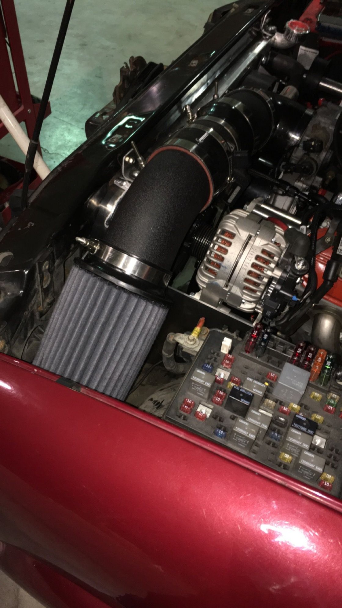

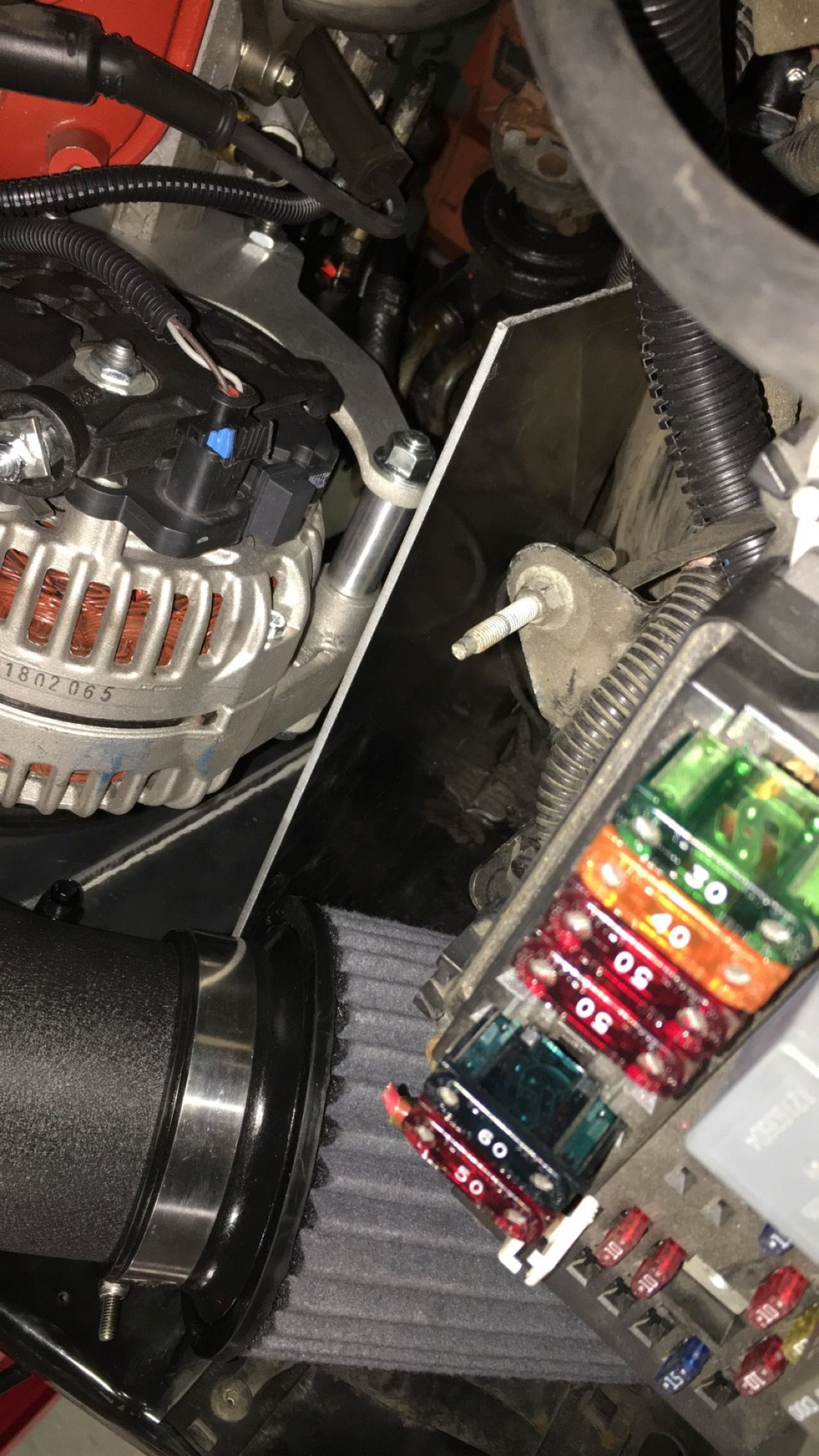

Working on intake for my S10 Swap and I was wondering if I should box in the whole intake area, or just do a heat/debris shield similar to what I’ve made so far?

I would box the entire air filter an leave a opening to fresh incoming air only. Or extend the air tubing farther to place the air filter farther away from the engine bay.
