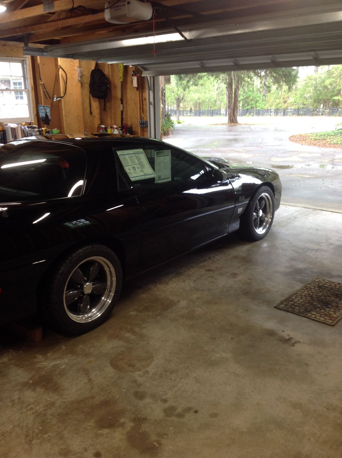

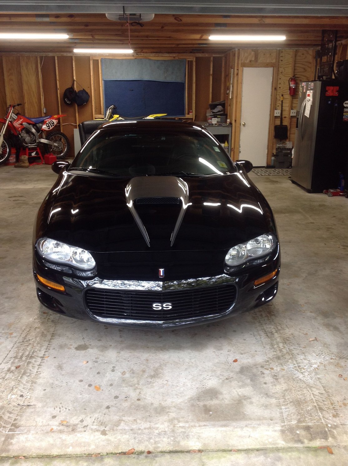

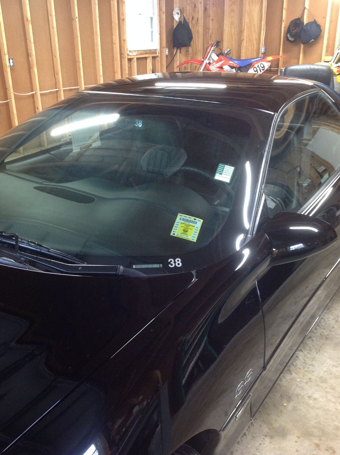

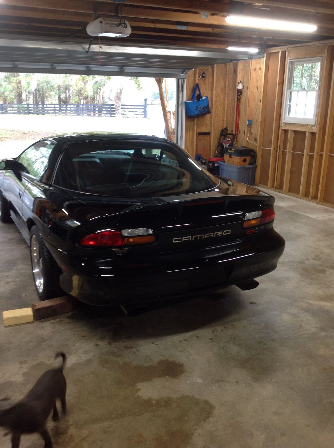

Home safe in garage. Detailing next.. Runs fabulously.. DEI #38

Wow. That's a serious find. A4 or M6?
Old Apr 6, 2019 | 06:14 PM
Dren's Avatar
Joined: Mar 2019
Posts: 272
Likes: 89
Thank you, M6, hard top, 3.73 rear. Beauty. Had a good look under car today on lift at Hendricks Chevy, no dissapointments..
