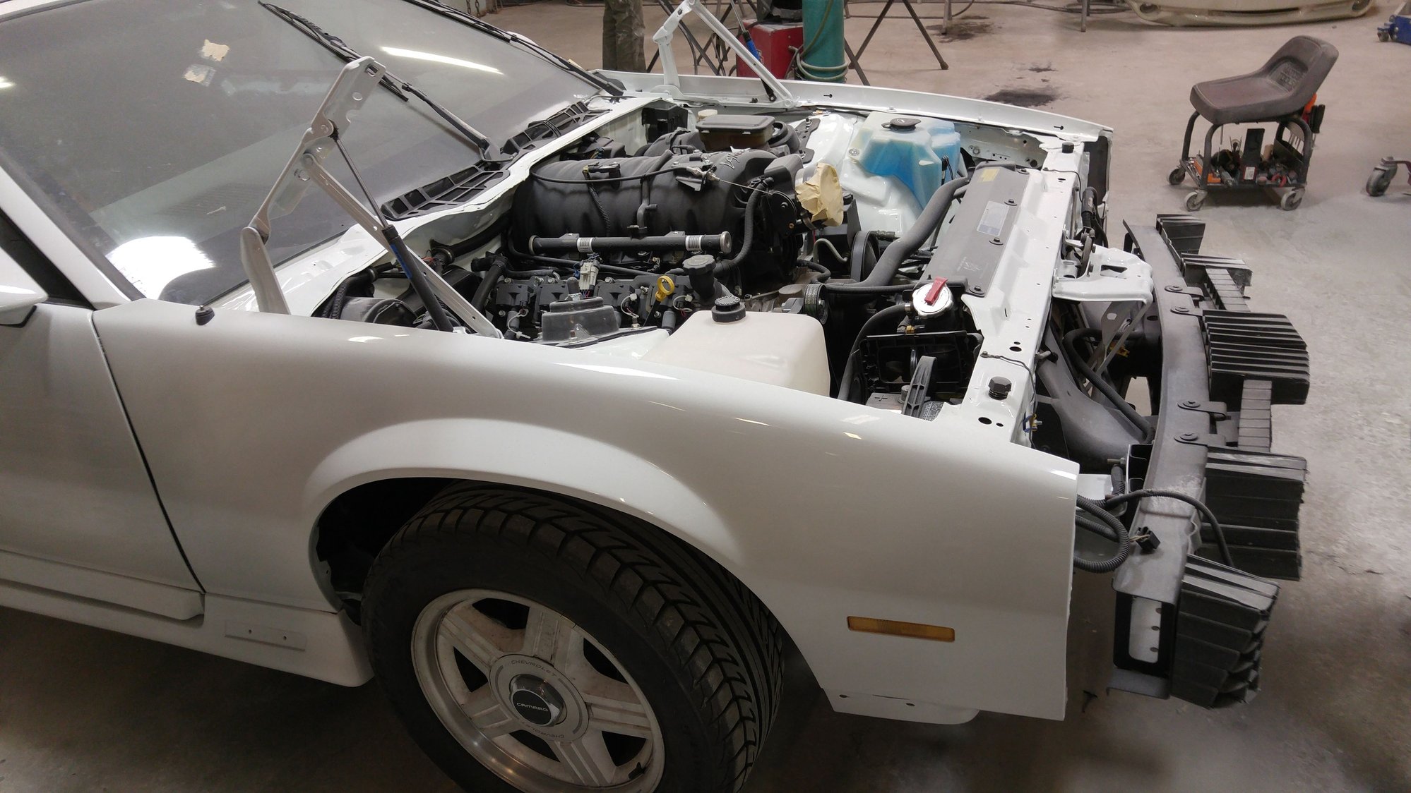

FWIW - My 91 RS had a full restoration & LS swap. I'd also planned and budgeted another for my 91 RS convertible.
It takes a lot of time to do correctly too or have done correctly. It's not a project for the faint of heart. It's also well worth when completed in my experience.
Most important part of the project will what is your budget.
Second most important part is do you love that Firebird.
Killer custom engine $8,000 to $16,000. 600 flywheel & 500+ whp is doable for ~$10,000
Get a great shop to do the engine if possible. Saves the and learning you didn't set preload correctly on the rockers and your new LS 427 has issues will suck. Thompson Motorsports has a great reputation. Bischoff Engine Service, Lingenfelter are renowned. Most LS1TECH sponsors do excellent work.
Superchargers are nice and easy way to make 800 hp flywheel and 700 whp $5000+
Tuning $500 to $1,000 for extreme set ups
Built 4L60e Transmission, torque converter, cooler & drive $4,000 to $5000
Built T56, clutch, drive shaft, new master, slave etc $4,000
Magnum T56 ( best choice in my experience), clutch, slave master, drive shaft $5000 to $8000 carbon fiber rocks
Built rear end, 9 inch or 8.8 or dana60, MWC aluminum housing tabbed 9 inch - $3,000 to $5000
Stock rear - free to $550 for a take out, it's a time bomb if you make power and get wheel hop...
Suspension - Subframes, savings, shocks, struts, chrome moly k member & arms, sway bars, RLCA's, Panhard, watts link, strut tower brace, etc $1,500 stockist to $4,500 with lots of aftermarket
Cooling - radiator & fans, stock $300 aftermarket $1,000
Wiring harness - $free to $1,200 depending on who does it
Fuel system - New high pressure set up for ~60 pounds of fuel pressure, regulator, fuel injectors $1,000 to $1,500
Brakes - atcleast 12 inch aftermarket Baer or better front & rear $2,000 and up to $3,500
Exhaust - 1 7/8 headers at least, y or x pipe, catback $1,000 to $3,000
Paint engine compartment $100 to $1000 professional
Paint car $1,500 low end to $5,000 typically good quality to $8000+ - New windshield look best $250
Aftermarket hood $600 to $850 for hood and $600 to make it fit right and fill imperfections on the underside and paint underside. Say $1200 to $1800
Body work $50 to $20,000 depending on if rust is present
Interior - hinge pins for doors maybe hinges too, weather stripping, seats, recover seats, dash pad -all typically minimum needs for a 3rd Gen - $2,000 to $4,000
Tire $600 to $1500
Wheels $500 to $5000
Hawk's Motorsports did my car. The car is stock reliable and I take the car on 1,300 miles trips on occassion.
It was well worth it and i would have it all done again
BTW - If one wants a 3rd Gen to handle like a pig, putting a BBC in the nose and adding weight will definitely do that.
