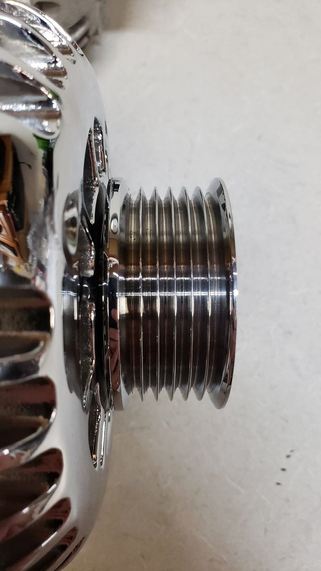

Well I found the problem. It ended up being the Alternator pulley. Shortly after I posted this thread, my Alternator died. So now I have 2 problems. Once I removed the bad alt, I compared it to my original alt on the bench and found a .080" difference in height. I contacted Tuff Stuff to get a new alt and explained to them the pulley height difference. After giving them some measurements of my stock alt pulley, they mailed me a new alt with the "proper" pulley.
Once I received the new alt, I compared all 3 I had and the new one was better but still off by .050. ugh.... After discussing the issue again with them, we decided it may be best to just use my stock alt pulley. I installed my stock alt pulley on the new alt and reinstalled it back into the car.
NO MORE BELT ALIGNMENT ISSUES. Yeah !!!! I put about 100 miles on the car since the install and all is good, the belt stays put, even after hammering on the car a bunch of times. Hopefully the new alt will last longer than 200 miles....
Stock Pulley
Tuff Stuff Pulley
