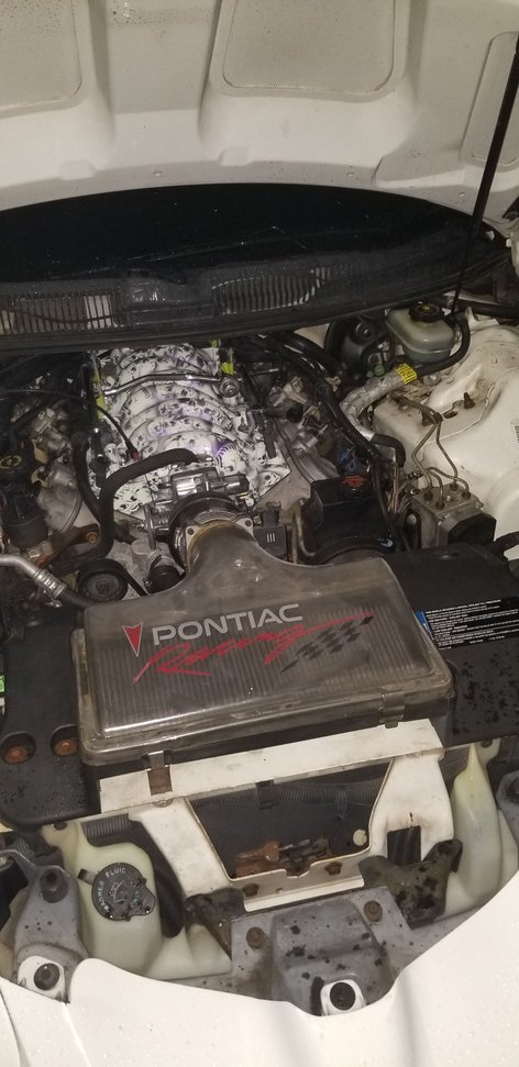

Anyone know what size bellow to run for a SLP lid to NW 92mm tb? Will be SD tuned so no maf, intakehoses.com has a few angled ones but not sure if i need straight or angled or what ID. thanks!

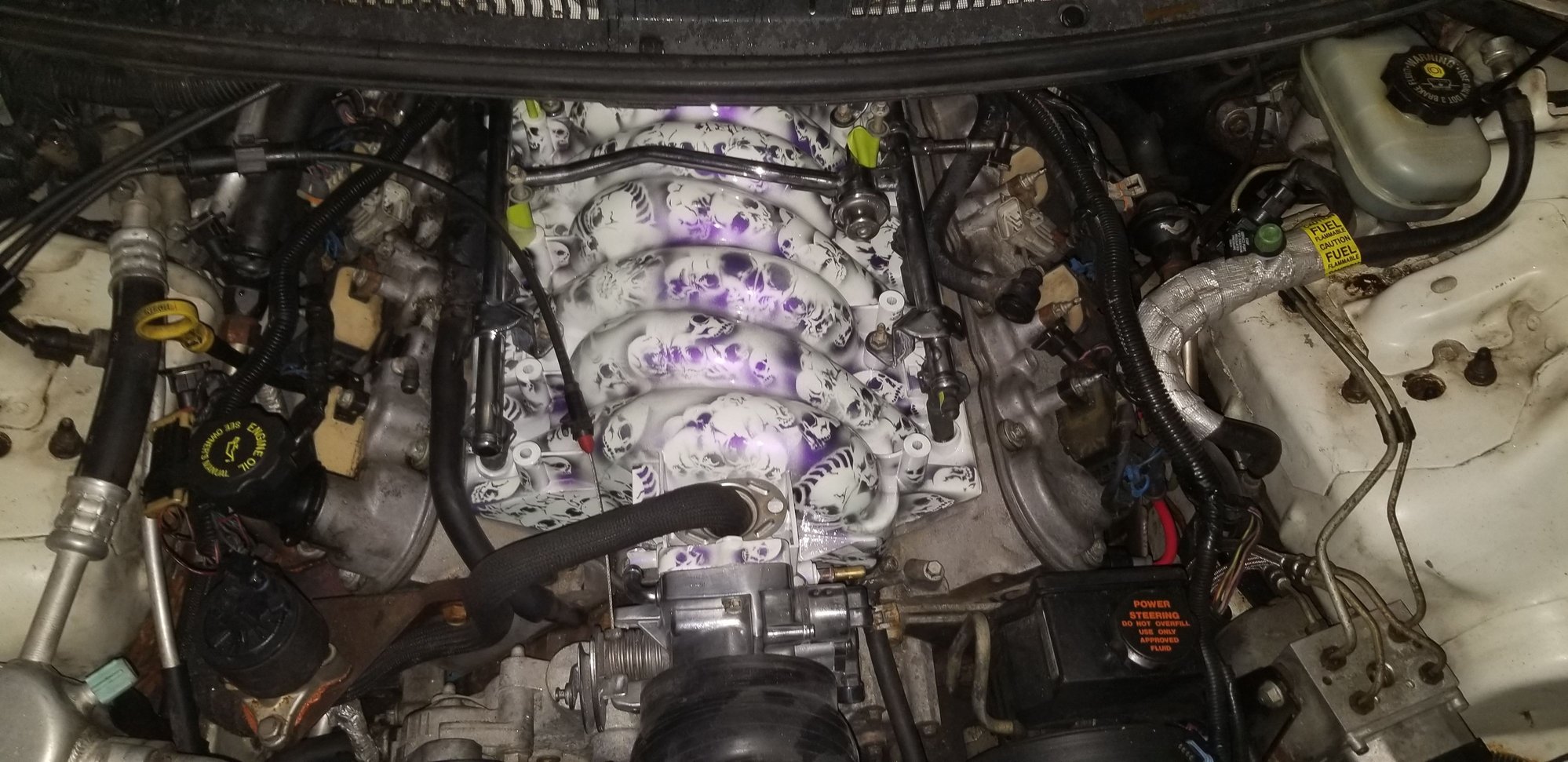

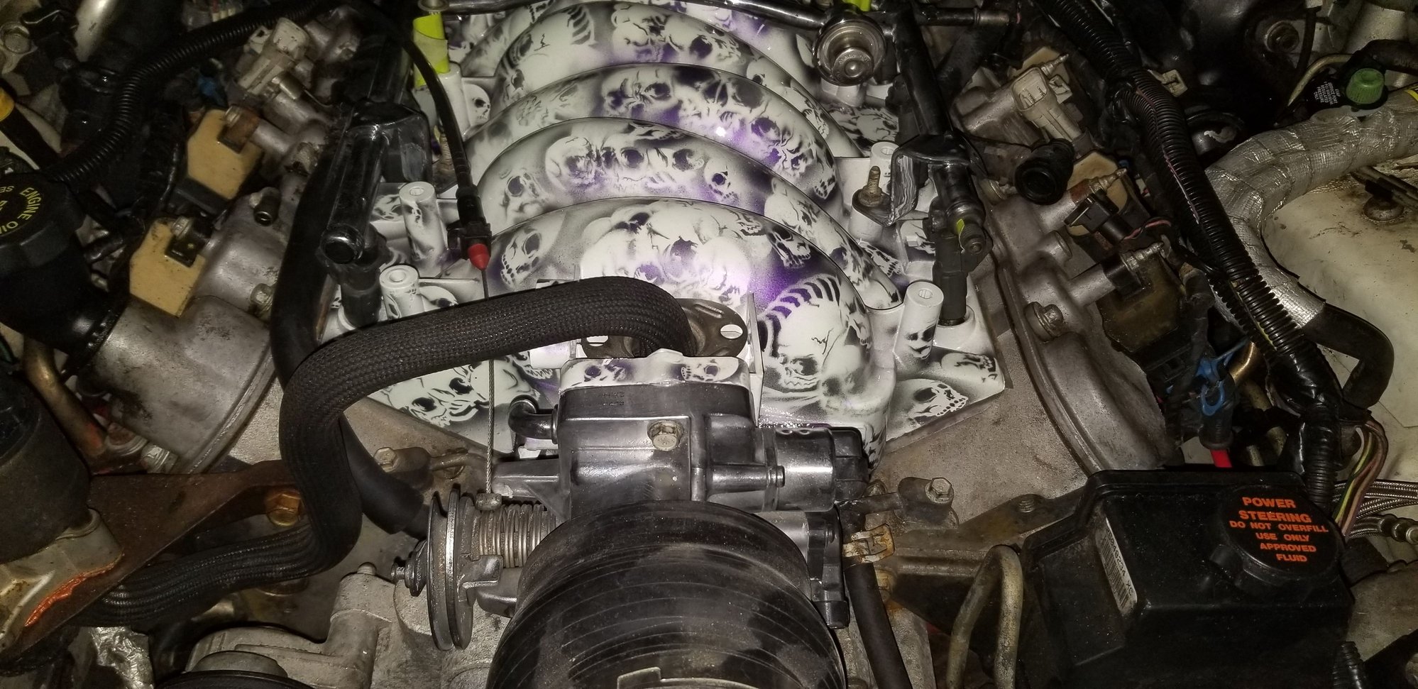

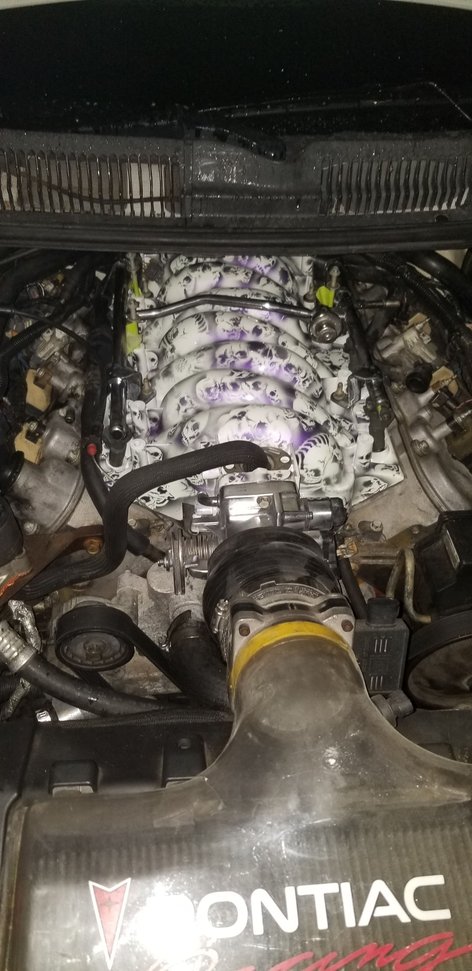

I think the gumby guy I got my car from used some crazy think drain pipe connector for multiple sizes from Home Depot. Made a small notch on the bottom where it slips onto the TB because it has a small blade there to i guess keep it straight up and down and it wont allow the mass AirFlow sensor to move and stretch the wires and potentially break them or anything else.
Here is a photo or two perhaps this might help????

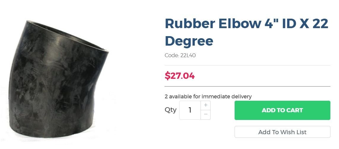

4" X 22* HUMP HOSE...at the place you listed above. You'll still need some trimming/custom fitting, but this is the angle that should work for you
