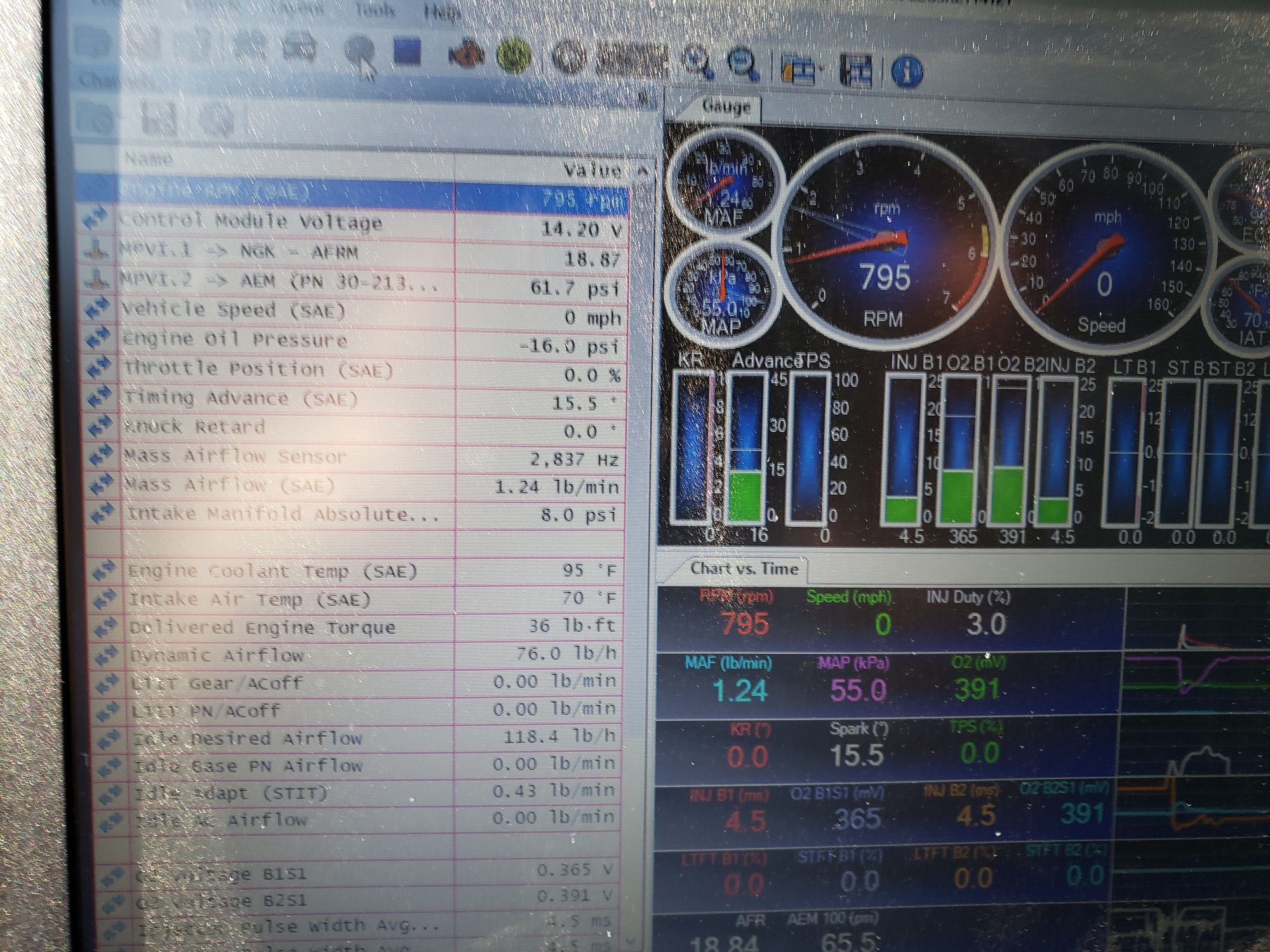

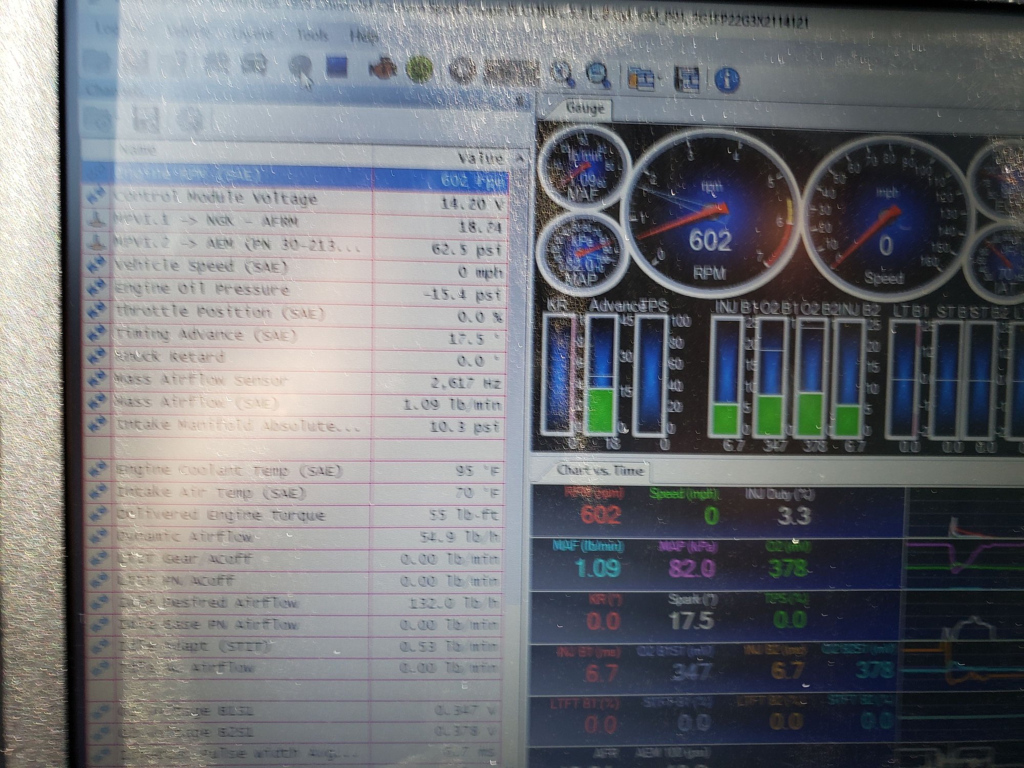

I've got hptuners and and a harbor freight scanner. I'll look
Old Sep 3, 2019 | 04:38 PM
fastlt1's Avatar
Joined: Sep 2005
Posts: 1,512
Likes: 20
at 795 rpm it looks like 2837 hz and 1.24 lb/min
At 692 rpm it looks like 2617 hz and 1.09 ld/min
Afr on both is above 18

Old Sep 4, 2019 | 06:10 PM
fastlt1's Avatar
Joined: Sep 2005
Posts: 1,512
Likes: 20
I drove 2 hours to get another one. Still doing same crap. Purrs like a kitten unplugged. Plugged up lean as heck. Check voltage going to it. All is good. Ohmed the ground it is good. Honestly I'm at my end. Help someone plz.

Like I said above it looks like it was reading close enough and you need to look at the 02 sensors next.
So again, does it run good cold and go to **** as it warms up?
Can you see fuel trims in the data stream, if so. What are the LTFT and STFT readings at idle.
Unplugging the MAF usually shows a bad maf but it can also show that it runs good in open loop and when you plug it in and goes to closed loop it goes bad due to other sensors reporting faulty readings.

Sorry it runs like butt cold and warm. here are two logs from hptuners. Thanks for the help.

Could a messed up map sensor cause this

In the data you posted above it looks like the map is reading correctly or at least close to correctly.

Look at the 02 sensors.
Let the car idle and warm up. Once warm or near warm, the voltage should go up and down and up and down from around .1-.9
Most important is that it varies fairly quickly above and below .5, so for example may go up to .7 then rapidly back to .2 then .8 then .1 then .7 then .2 it should go up and down quickly on both front 02 sensors which in the data stream are 02 sensor B1S1 and 02 sensor B2S1
The B1S2 and B2S2 are the sensors behind the catalytic converters and do not matter, those just monitor catalytic converter function. Make sure you are looking at B1S1 and B2S1, those are the front ones and responsible for air fuel ratio readings.
In both your pics above both 02 sensors are at .3xx volts at both times you took screen shots. That's very odd. They may be stuck. Also your long and short term fuel trims are at 0 in both pictures. That's also funky. The short term moves up and down with the 02 sensor readings and the long term is an average of the short term and or compensates the short term compensation. Long story on how it works. But it shouldn't be 0 especially if you are running rich or lean.
Those numbers could be because it's in closed loop, it shows to be at 95 degrees coolant temp on the screen. Take pics with the engine fully warmed up. Should be around 180-200
