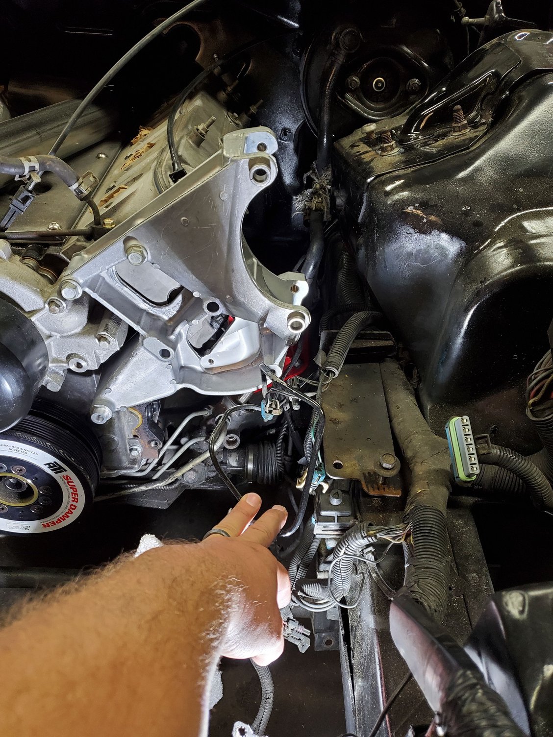

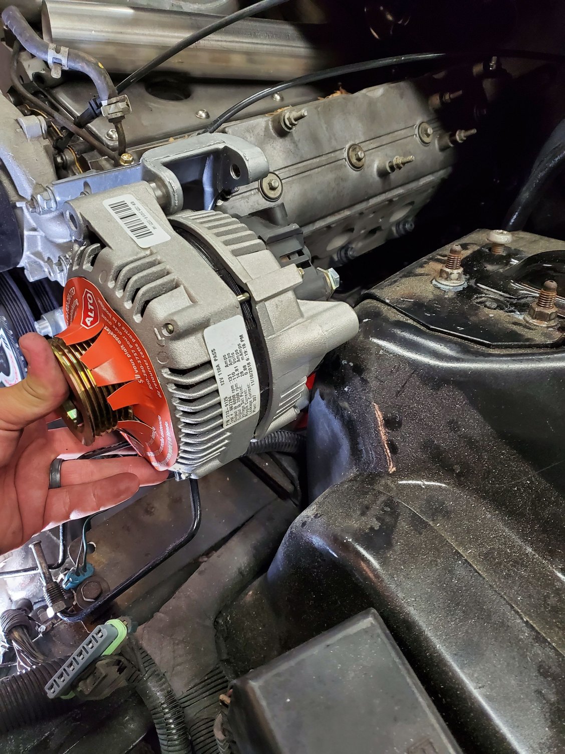

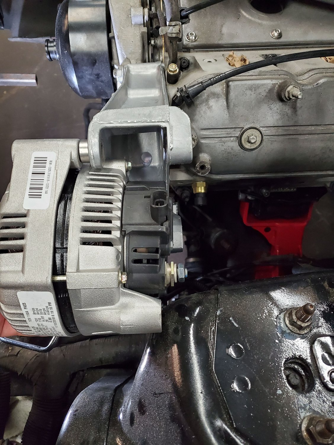

Guys I have a 1994 Camaro Z28, 5.3 is in, trying to sort out the accessories now. This will be single turbo application. I am running corvette offset. I installed the alternator/ps bracket from a 99 corvette and the alternator is all up in the fender. What is my next move? I'm at a loss, modifying the fender isn't an option, its way too far into the fender.

Is moving it to the passenger side out of the question?? if not this may work for you
https://www.cbrperformanceproducts.c...2011-cs130.htm

Jegs sells an adjustable alternator mount for the LS. May allow you to pivot and reposition alternator. It also mounts closer to the block than the factory bracket.
